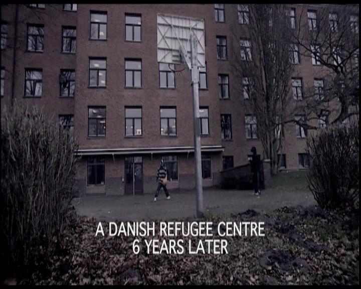

    For a client I need to subtitle videomaterial which already contains english hardsubs.
    I do this in VirtualDub with Gabest's Textsubfilter. Synced my subtitles to the existing
    hardsubs so they are identical in timing. My first idea was to place my subtitles on the
    english ones with a black opaque box, but I'm not satisfied with the results.
    That's why I thought I should give it a try with MSU Subtitle Remover.
    The big problem now is the SETTINGS. Especially the values for the area. As soon as
    I change this Virtualdub crashes. Can somebody explain to me how I should interprete
    these parameters?
    Here's a snapshot of the material I'm dealing with:

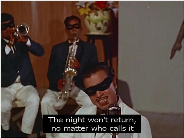

  8. I was fooling around with it some more to try and make it compatible with your (inferior, in my opinion) workflow. I opened a DVD in DVDSubEdit, made the changes as described in that thread and saved my work. I tested the DVD and then had nice selectable subs just the way you wanted them. Except that they were selectable. I extracted the SUP file using PGCDemux. I took the SUP file and opened it in SubtitleCreator and immediately saved it as VobSubs (IDX/SUB format). I also could have extracted the VobSubs directly using VobSub Configure (comes included with the VobSub package). I opened the video in VDub (Mod in my case) and rather than using the TextSub filter, I used the VobSub filter, scrolled to my VobSubs, edited them to lower them a bit, and this was the result:

  11. Geez, did you not understand what it does? You said you already have subs. This takes those subs and adds the same amount all around all the time. Look, here's a shorter line, also with 20 pixels of black to the right and left, and 8 pixels above and below. These amounts are adjustable. You can make the box as large or as small as you want, relative to the size the subs themselves take up. Yes, sometimes one language will take more letters/words to say the same thing than it does in another language. If you like, you can make the black extend all the way to the sides, although that shouldn't really be necessary. And one really good thing about it is that the black box appears only when the subs are showing.
