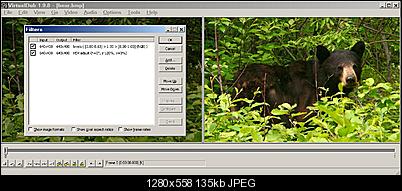

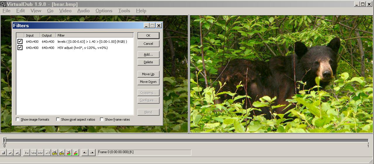

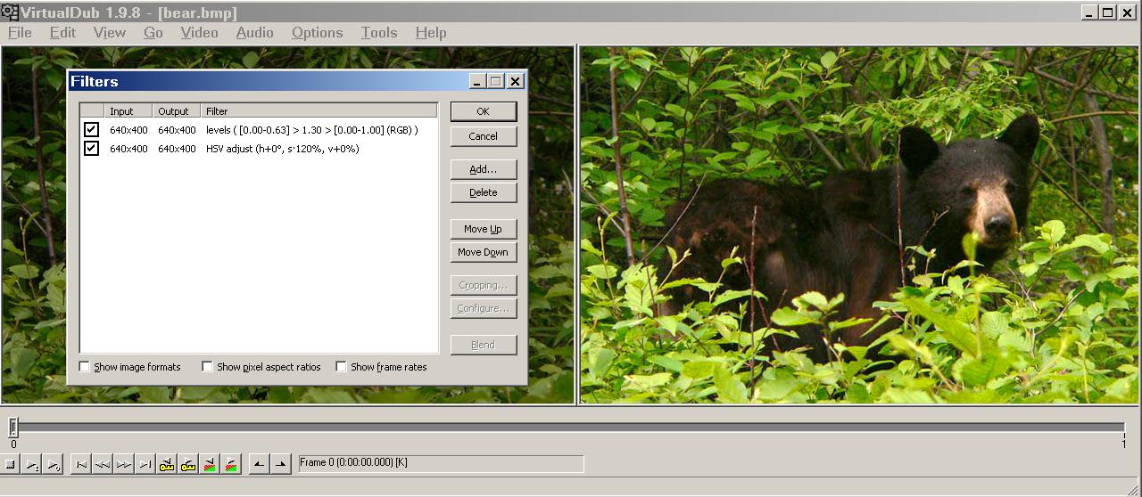

  5. I agree, Gradation Curves is infinitely tunable. But you can get very close to your PS sample with Levels and HSV. The before image from your post with the Levels and HSV:
    Just about all video editor have these controls.
