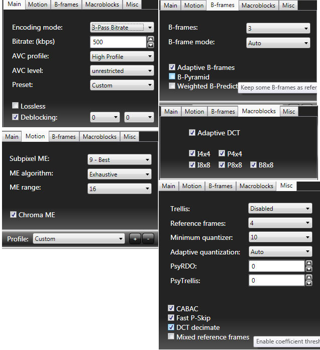

  16. Hmm, I must be missing something. I did find subpixel me 9. Thanks.
    Here are my settings and the latest.
    So far, render time is under a minute.

  17. you got it, subpixel me is already 9 in those screenshots
    i would only use 2-pass (3-pass is a waste , no additional benefit)
    me algorithm is exhuastive - that's a waste too - i would lower it to multihex as suggested earlier
    I would checkmark mixed reference frames
    For additional efficiency I would normally use b-pyramid (b-frame references), and more b-frames (maybe 4-5 or even more depending on content), slightly more reference frames, but at higher HD resolutions it can bog down flash playback (normal software decoders in media players are fine). For your tiny resolution you can enable it for slightly more efficiency
    The different settings can be adjusted in different scenarios for tweaking. One "set" isn't necessarily best for all types of content. If you want to learn what they do, you can do some encoding => adjust settings => examine encode

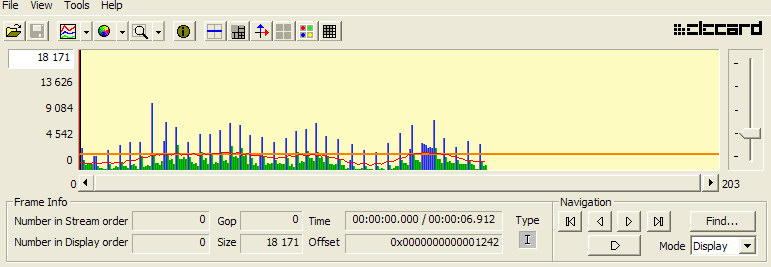

  20. Finally there's no fixed rules. YMMV . Basically, every source is different and may require different filtering, different encoding settings, different treatment, etc... every program/filter has quirks/idosyncracies (like premiere )
    If you have no fades or dark scenes, activating mb-tree is very beneficial (i don't see it available in your screenshots, it might be your x264 version is too old.) If your content is basically the same (like just guitar playing, or computer tutorials screen captured ) , I highly recommend turning it on. But warning: It treats P-frames before the fade very poorly, so if you have fades, dark scenes I wouldn't use it at all.
    I knew ahead of time your content would benefit from more b-frames because a lot of it is static or similar type scene. If you look at the analysis below (the green are b-frames) , you have strings of 4-5. Things like tutorials, some types of anime, and guitar playing usually benefit from even more. Most types of content like live action and hollywood movies can only make good use of 2-3. If you learn to read your encode logs, you can use that information to optimize your encodes (it will tell you percentages of frametype distribution)
    You have to make trade offs too, because there are diminishing returns for a lot of the settings. 10x slower for 1% compression gain isn't worth it for most people
