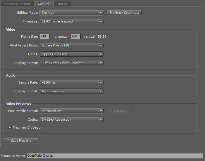

    I took it into a PP project with the settings below and did *nothing* to it.

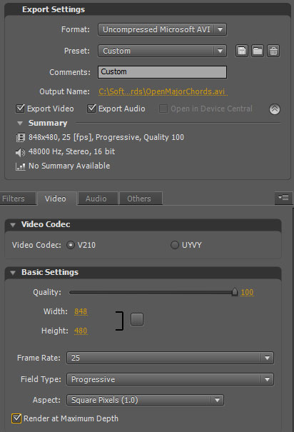

    I exported it and it reduced the fps and the size of the file.
    WMP cannot play the resultant avi file.
    Any ideas?
  14. sequence preset should be same as your web video and photoshop psd size 368x272 , fields should be none (progressive) because you deinterlaced the import
    export should be the same as well 368x272 unless you are doing some other resizing later, and 29,97 fps, since your input was 29.97 wasn't it (didn't you start with 60i video?, what did info() say about the fps) , so why did you set it at 25?
    you could leave everything at 848x480, and export then encode & resize later with avisynth if it looks fine (you just have to change the frame rates)
    v210 is 10bit uncompressed 4:2:2, and most video players won't be able to play that. Don't checkmark render at maximum depth, that's only for 10-bit video like v210, cineform, prores
    format should be "microsoft avi" , not "uncompressed microsoft avi", and codec should be "none", which will give you uncompressed 8-bit RGB.

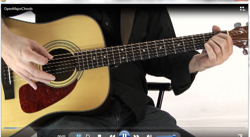

  15. That fixed it. The size is 848x480. I want to do all the cropping & moving in PP then do the final crop & downsize using avisycnc as you suggested.
    For now I just wanted to see if I could import & export a usable avi of the result from the preprod script from PP.
    This time WMP can play it.

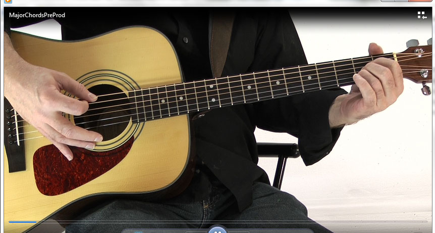

    I looks a *lot* worse than it does before I bring it into PP:
    Look at before the PP export, after the PreProd script & After the PP Export:

  16. because your sequence was set to interlaced (upper field first). set it to progressive and keep it progressive on export
    also right click the clip in the clip bin and interpret footage. what does it say?
  17. Even in the vid before the PP export it doesn't look that great.
    The deinterlace doesn't seem to have helped any more than handbrake.
    See, the strings are still a bit jagged; about like I had when I first used handbrake.
    My competitor is still *much* more clear.

  19. OK, I see that. I set up the project again using progressive.
    It looks much better.
    What do you think of the first one above?
    That's the one that's after the preprod script, before PP.
    Here's the result after the PP export (using a progressive project).
