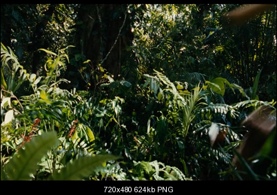

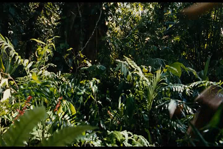

  12. I didn't get any change in contrast when I converted. Both look the same. Be careful how you compare. Two media players playing the same video side by side may look different. One will be using the graphics card's video overlay feature, the other will not (only one program at a time can use video overlay). Depending on your video overlay proc amp settings the videos can look very different.
    HcEnc sample:
    Xvid4Psp sample:
