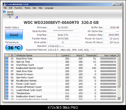

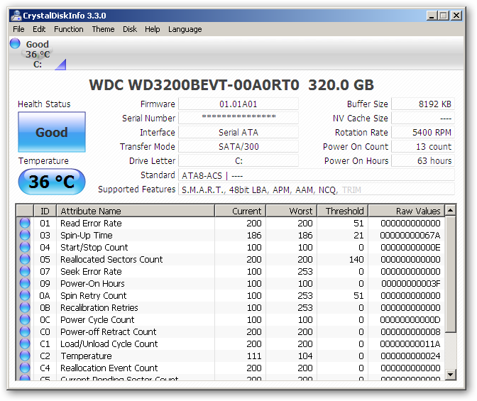

  7. Originally Posted by PartingShot View Post
    Based on this, should the Maxtor drive be tossed? Or is it worth keeping it since CHKDSK says it made the necessary repairs?
    Check hard disk S.M.A.R.T status with CrystalDiskInfo or HDDscan
