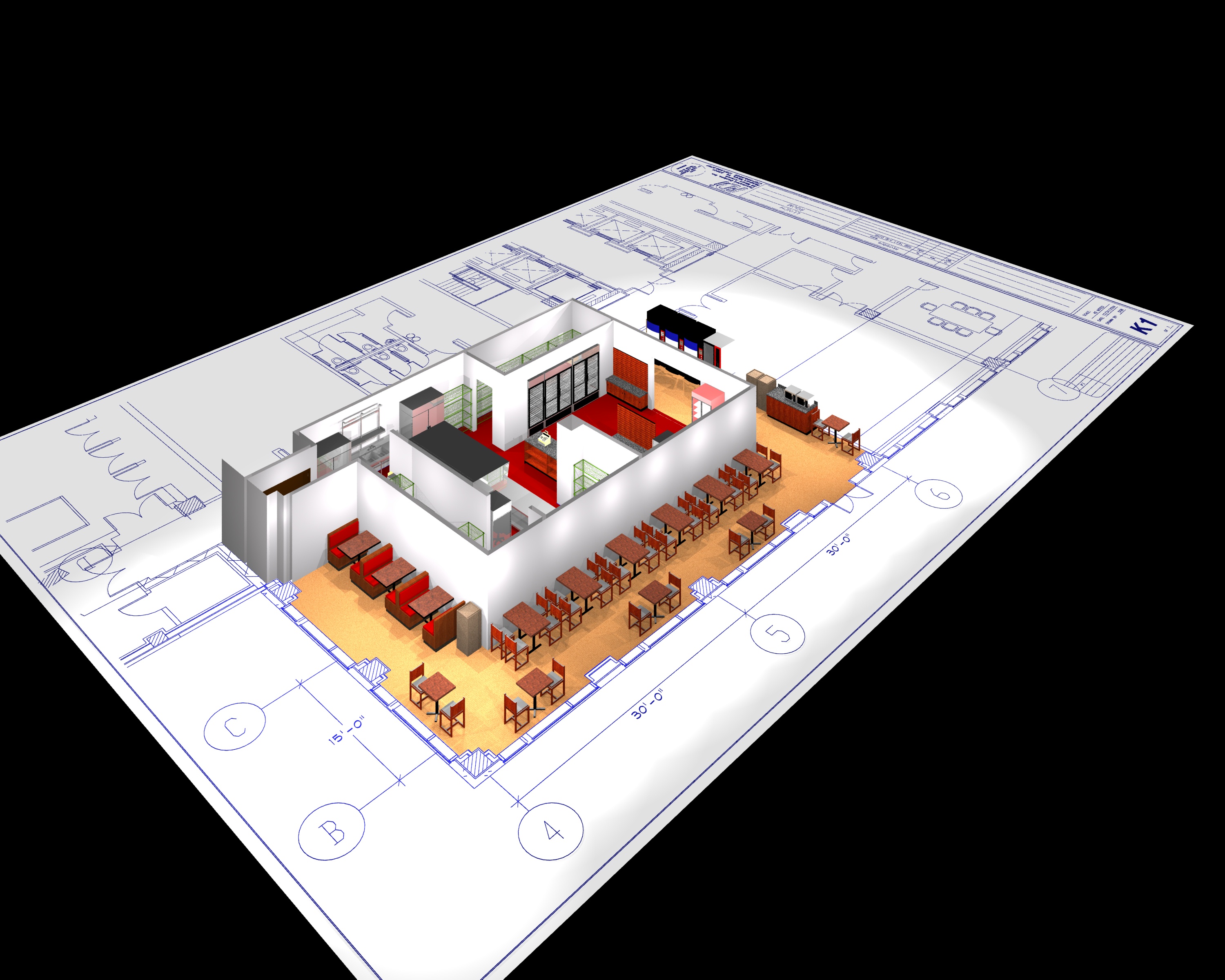

    Thanks. I do this type of render work everyday. The animation is a pantry kitchen for a local food bank. It helps management and staff visualize what their new kitchen will look like. They are not usually adept at reading blue prints.
    Thanks for your time!
    avisynth still looks interesting. Just need the time to invest. -David

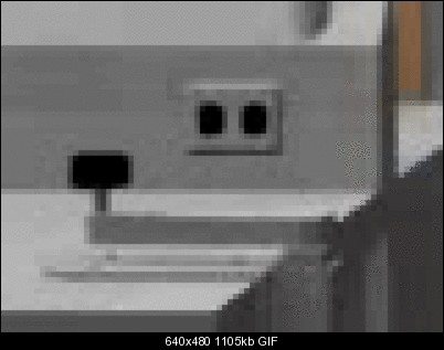

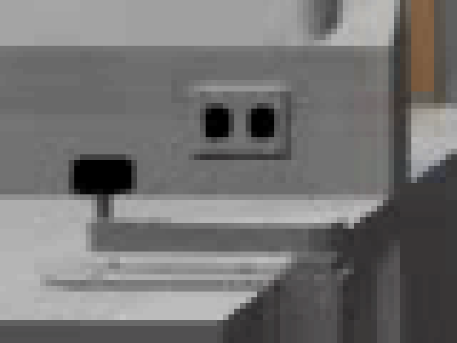

  6. Another thing to watch out for with Xvid (all MPEG family encoders, really) encoding is DCT ringing artifacts. Here's a nearest neighbor, 8x, zoom into a small section of your Xvid AVI file. Notice all the dancing dots around high contrast edges:
    This can be seen in the JPG files you uploaded earlier too (JPEG uses DCT too). You can alleviate this to some extent by using custom matrices.

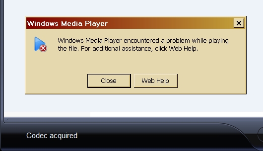

    Getting this error. It looks like it found a codec but didn't install it.

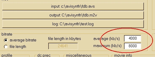

    Are you saying to change the bitrates here to 30,000 and 50,000? Thanks! -David

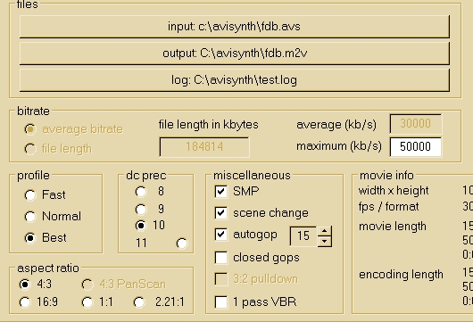

  12. yes, you need somehting way higher like 30,000 and 50,000. MPEG2 compression is poor compared to h.264. h.264 would look better, higher psnr at 1/2 the filesize or bitrate, but because of that compression, it's more taxing on the cpu for Decoding => harder to playback in realtime especially on a single core laptop

  18. I not real good luck with m2v. With the initial lower settings, I did get windows media 11 playing the whole thing.
    used to higher settings ( and switched to 4: 3 ) and now I get a blank screen that resets every 7 seconds

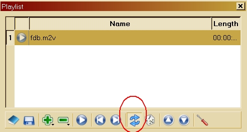

  22. Originally Posted by poisondeathray View Post
    There are portable usb versions as well, so no need for installing or system admin rights.
    That sounds interesting. My intentions are to give the end user a flash drive, hopefully self reliant or at least very compatible to most XP boxes. I have 1 vista box and would like to trash it.
  23. Originally Posted by poisondeathray View Post
    smplayer has a repeat function (play=>repeat), includes internal codecs, and also has a usb version
    It's very well hidden <g> -David

  27. HcEnc can limit the peak bitrate in Quantizer mode to prevent bitrate peaks that are too high for some players. The control is on the Setting 1 tab near the Quant Value, "Check VBV/Max Bitrate". If you enable that the Max Bitrate setting on the Main tab will be in effect. During any section where the bitrate would exceed that limit a higher quantizer (lower quality) will be used to prevent exceeding the peak.
    Another tool you'll find useful: BitrateViewer
  28. Originally Posted by jagabo View Post
