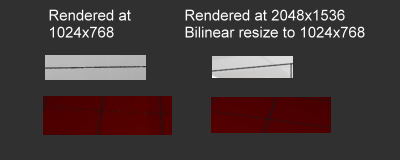

  16. Originally Posted by David Bethel View Post
    I tried to outsmart VirtualDub by resizing to 100 with Precise Bilinear but it was smarter than me. The output files were identical.
    Of course. Here's your 2048x1536 frame resized to 1024x768 with VirtualDub's Bilinear option:

  19. Originally Posted by jagabo View Post
    I got about they same results on this end with VirtualDub so I must be doing something correct. It just adds a ton of time on the front end.

    I think you are missing the point. Look at the thinnest lines in the downsized video compared to similar with lines in your original videos. The new ones are much smoother:
    Those rough broken lines are causing the buzzing edges you see during motion.
    Over-rendering like this is one of the basic methods of antialiasing.

  23. Originally Posted by jagabo View Post
    I think you are missing the point Over-rendering like this is one of the basic methods of antialiasing.
    I understand. I could see the difference of line edges on the frame that I did here @ 2,048 x 1,538 and then did the resizing. It's just that it will take 3.5 times longer to render the images. Maybe I'll try 1,536 x 1,152 ( 50% bigger ) and see how long that takes. This particular presentation is (2) 1,514 frame animations spliced together, once with a forward path, once reversed. 3028 total. -David
