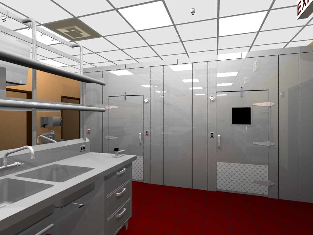

  25. Things are getting a lot better. I think that the frames that are still problems are scenes that the camera moves and rotates too much in relation to the distance objects in the scene. Especially if the object have very sharp or defined edges and color borders. IE a black gasket seam between stainless steel wall panels like this. The further away the camera, the smoother the video images. -David
  26. You need more antialiasing when you render. Those buzzing edges are in your source. If your renderer doesn't allow for more antialiasing render much larger frames (eg 4096x3072) and downsize in VirtualDub.
  27. Also make sure you use the .tiff to render the sequence, not the lossy jpegs.
  28. I have the antialiasing set as high it will go for this software. These are produced on a quite old ( 1991 ) release of AutoCAD R13 and Accurender ( AR2 )
    I'll checking into the tif format. I remeber some types of tiffs didn't work well. I know that tga is fine.
    I'll look into large frames. It takes about 1 minute 20 seconds to render each frame ( about 1,100 per day ) @ 1,024 x 768. The newer software is a bunch slower ( 20 x )
    Thansk! Again! -David
  29. sorry, tga is fine; for some reason i thought you were using tiffs; the point is NOT to use jpeg for the actual video
  30. The buzzing edges aren't caused by color subsampling (color subsampling makes no difference in grayscale areas). They're caused by insufficient antialiasing and were common in 3d rendering in early 90's. You're stuck with them unless you can increase the output resolution. You might try using a lower antialiasing setting in ACAD and rendering large frames. Maybe you can find a compromise solution that doesn't take too long.
