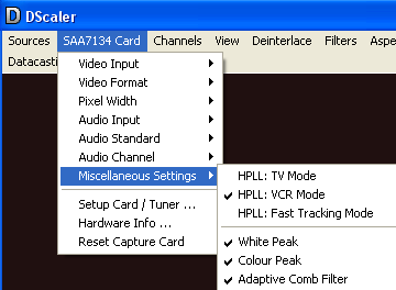

	I just built Sempron 2600 (i thought it was 2300) sblive, gf2 mx, and saa7134 card , installed XP and dscaler. Hooked up video to composite in and recorded a clip No problems... Pretty sweet. Is there anyway in dscaler to know how many (if any) frames are dropping?

 Is dscaler still recommended to take advantage of the 878 card, as I notice it has a lot of specific options in it for those cards when it detects one?
 Or is the like of BT tweaker in Vdub etc considered the way to go? Ill probably end up testing a few different softwares.
 edit - just realised bttweaker uses the same dlls as dscaler, so it's a moot point..Last edited by jafvid; 1st Mar 2010 at 18:37.
