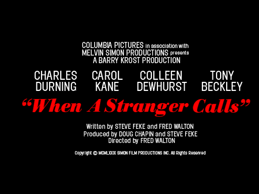

    I think I did a fair job here. Perfect, no... but even "the pros" don't get it perfect. I'm a bit peeved 'cause I noticed that I idiotically used the wrong font for "BECKLEY".
    Any advice for how to improve? I wouldn't mind some constructive criticism, please
    [Attachment 887 - Click to enlarge]
    [Attachment 888 - Click to enlarge]
    It's pretty close.
    I think that the original fonts are a bit heavier, both the sans and the title font.
    Eg, if you're using "Regular" weight, try "Medium".
    Also the original italic title font has a few degrees more tilt. But if you can't find a better match, don't try to distort the fonts, font design is a lot more subtle than that and it's better to use it as designed. The difference is only apparent when you see them side by side.
  22. Nice job. Better quality than the rest of the movie, I think. It might even look 'too good', as poisondeathray mentioned earlier.
    There's no reason you can't fix the 'Beckley' by covering it with black and rewriting it using the right font.
  23. Cut and pasted letters for Beckley, tilted title a little more:
  24. The red fonts don't quite match.... for example the "g" in "stranger" is using a different style , and the strokes are thinner for the rest....Maybe you could use a "g" from a different font set. Anyways, I doubt many people will notice
    Now only if you could make the rest of the trailer that squeaky clean
    You should never mix fonts in the same word -- if you must have the other form of g, swap the whole font.
    There are many, many variations on that style of font around -- it's called a Didone or Bodoni.
    But since you are replacing the original text, it doesn't have to match exactly.

    Yep, Bodoni is what I used, but I have a million variations of it installed and had trouble finding the "right" one.
