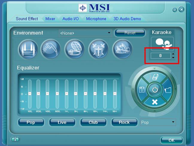

  4. KMPlayer has pitch bending but it uses a slider. It's not half-tone based. So it will be hard to get the exact pitch you want.
    Many audio card's have the ability to change pitch. Look through your audio controls. Here's the control dialog from one of my computers:
    The control marked by the red box changes the pitch by half-tones and effects any audio being played. Look through Control Panel for audio/karaoke controls.

    Jagabo: I checked my audio controls but have nothing like that unfortunately. This computer is too old I fear. I checked out KMPlayer, but I just don't know enough.
