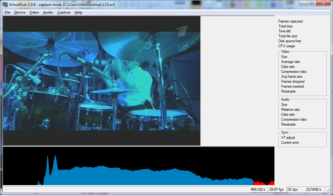

  1. Hi I have honestech tv capture device, I am trying to capture my live tv signal, and i am having the following issue. When ever someone moves or something moves there is a line trail around that area. I have attached a screen shot as an example, is there anything I can do to resolve that issue in virtual dub.
    Thank you!

    This is interlace. You don't want to remove it, if making DVDs or archiving the video.
    See the interlacing info about halfway down this page: http://www.digitalfaq.com/guides/video/capture-understand-sources.htm

    You handled your video incorrectly somewhere along the line. You have to spell out exactly what software and settings you used. Then maybe someone can point out what you did wrong. Just looking at the VirtualDub screenshot you posted it looks like you resized the frame. That's one problem.

  14. Hi,
    I am using virtualdub in capture more with no compression.
    Signal is ntsc
    I set the size to 640 by 480.
    If I did anything wrong, let me know, and if I should use video compression, let me know which one.
    Thank you!
