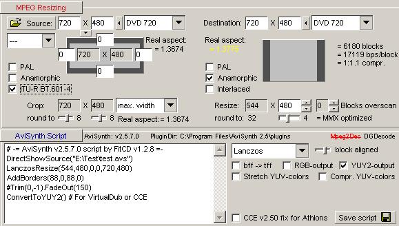

  2. You can have 4:3 and 16:9 videos in the same DVD, as long as they're in different VTS's. If you want to add pillarbars to the 4:3 ones and reencode for 16:9 so they can be joined to the already 16:9 ones, the tool of choice is AviSynth with its Crop, Resize, and AddBorders commands. Exactly how you do it depends on the original resolution of the 4:3 videos, and whether for PAL or NTSC. FitCD will give you the right commands for doing this. For example, if 4:3 and already DVD compliant, for NTSC the script might go something like this:
    LanczosResize(544,Height)
    AddBorders(88,0,88,0)
    That says to resize to 544x480 and add 88 columns of pixels to both sides.

    No, you do both at the same time, setting up the script to convert from 4:3 (or whatever the source DAR) to 16:9, and then feeding that script into your MPEG-2 encoder. I don't (and won't) use WinAVI, so I have no idea whether or not it accepts AviSynth scripts, although most encoders do. Baldrick says there are all-in-one programs that can automatically add the pillarbars, but most 4:3 to 16:9 conversions I've seen (like that done in DVD-Rebuilder) do the conversion by cropping from the top and bottom and then resizing. I don't use any of those all-in-ones, so maybe he or someone else can give you the names of some so you don't have to learn AviSynth from scratch for this project.

    I don't have (or want) K-lite. I don't use ffdshow for this. You make a text file renamed with the .avs extension, use DGIndex (part of the DGMPGDec package) to make a D2V project file, and inside the Video.avs have something like:
    LoadPlugin("C:\Path\To\DGDecode.dll")
    MPEG2Source("C:\Path\To\Video.d2v")
    That's for a 720x480 4:3 MPEG of some sort that you want to convert to 16:9 by reencoding. Read the docs included with DGMPGDec as they are very good at explaining what you need to do. Then at the AviSynth site is more valuable information:
