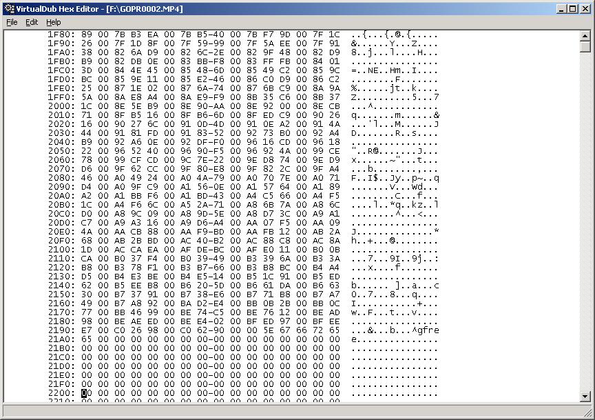

  7. Most of the header of the bad video was empty (all zeros). I copied the header of the good sample to the bad sample and it comes close to playing. I was able to see the first frame of the video. Maybe if you do the same you can find an MP4 file fixer that can recover the rest of the video.

  9. I used a hex editor from HD Software: http://www.hhdsoftware.com/ I copied the first 0x2200 bytes. I don't deal much with MP4 files so I don't have any repair tools for them.

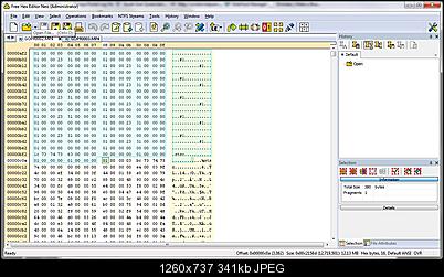

    I can't even get it to show the first frame on the big 2GB file. Not sure if I am doing it correctly. Is it up to this point ? I am looking at the numbers on the left hand side.

    Mar 2008
    It should be to about here. Notice in the good file it is followed by x"00" unitl it gets to approx x"8000"

    Feb 2010
    Brisbane
    Hi Dave
    your link is giving me a bad attahcment error message.
  13. I copied the first ~0x2200 bytes (that's about 8700 bytes in decimal) from the good file to the bad file. That's the lines labeled 00000000 to 00002200. You'll see that the bad file has nothing but zeros from about 0x30 to 0x8000. The good file is all zeros from about 0x2200 to 0x8000.
