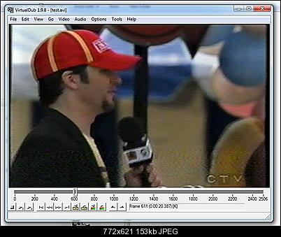

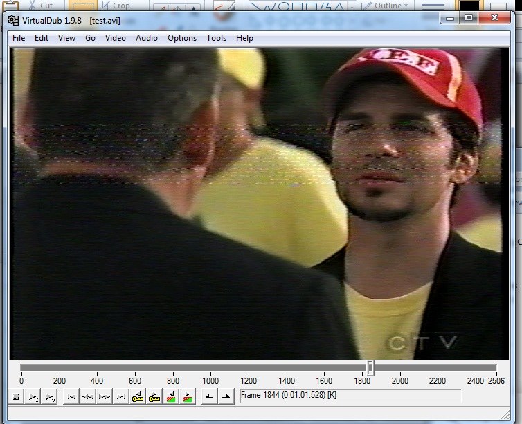

    I hooked up my VCR directly to my TV (with composite cables) and the quality is good. However, once I hook it up to my PC (VIA canopus ADVC 110 and composite), I get too many horizontal lines and some tracking-like fuzziness throughout. None of this is visible on the TV.
    I had originally purchased a dazzle to capture, but after reading this forum, it seemed that USB connection was not best (so I went out and bought the Canopus). I thought my problems were solved. No go.
    I have used different software to capture the files (Pinnacle Studio 14 and Virtual dub), but same issues, (albeit Virtualdub a bit better). I can edit it in Pinnacle and burn in nero, Pinnacle Studio or Roxio, but it seems the issues come before the burning of the DVD because the vdub screenshots below show the issues I am having.
    Do I need an SVHS (for s-video hookup?). If it is my VCR - why is it clear on the TV? Is it a filter I should be applying in the vdub? I am so confused.

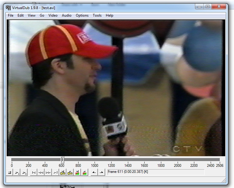

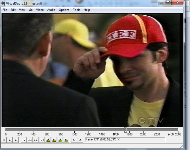

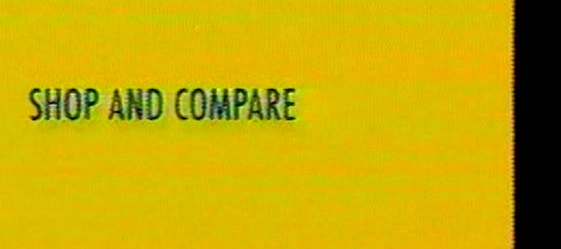

    Here is a screenshot from final DVD - super blurry.

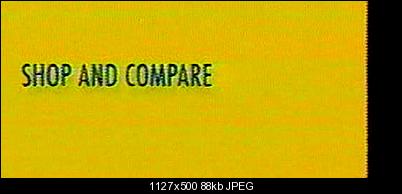

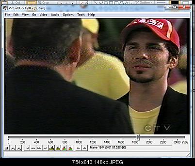

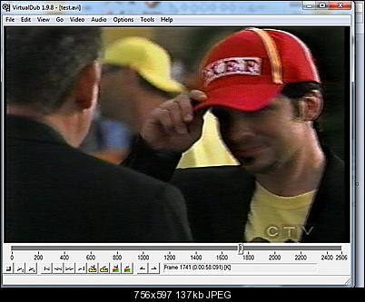

    Here are screenshots after capture (but prior to burning) on PC:
Name:	vdub capture2.jpg
ID:	551Click image for larger version
Name:	vdub capture1.jpg
ID:	550Click image for larger version
Name:	vdub capture3.jpg

  2. The first image is showing line time base errors and dot crawl (actually all four images suffer from this but it's not as noticeable in them). An SVHS deck and s-video cable should take care of both of those problems. I'm not sure what's causing that horizontal band of noise in second and third images. The last two images show clear comb artifacts from interlaced video -- completely normal.
    That band noise is transmission noise, most likely. Maybe power line, but more likely transmission.
