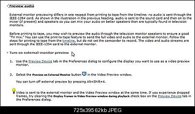

    Here are the Vegas instructions for monitoring the timeline via IEEE-1394.
    This can also be done from Vegas Movie Studio, Premiere and Premiere Elements, Apple iMovie, etc.
    http://www.kiva.org/about

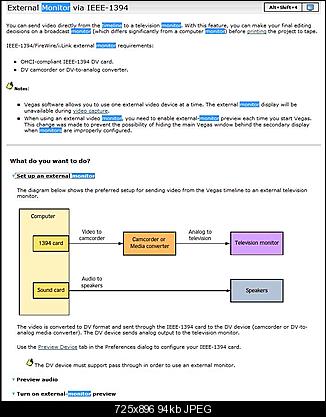

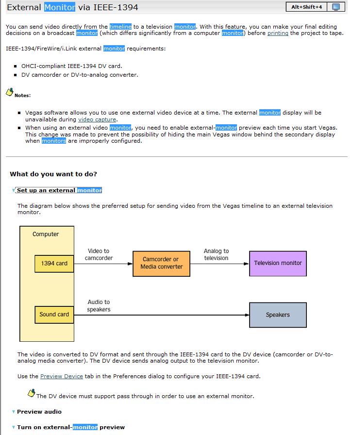

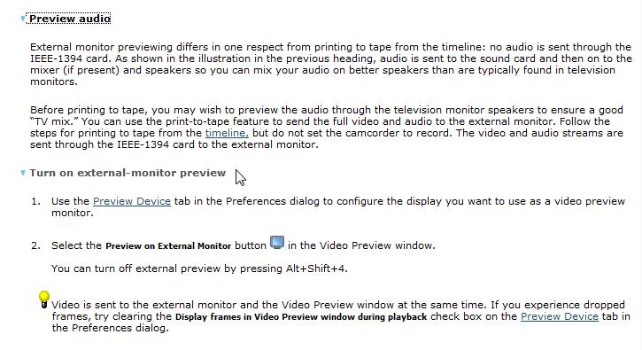

  9. Member edDV's Avatar
    Mar 2004
    Northern California, USA
    also
