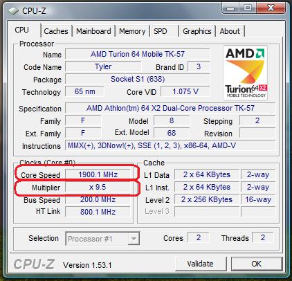

    It should be 11X for a multiplier, I believe. In CPU-Z, the CPU speed is shown, then the multiplier. The CPU speed is the bus speed times the multiplier, 1.9Ghz from my laptop screenshot:

    Your bus speed should probably be 266Mhz X 11= ~2930Mhz.
