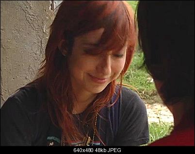

  9. Funny, it occurred to me that the missing frame could be restored from the two blended frames and the two surrounding frames because, given 3 frames of film, A, B, C, the blended video sequence looks like:
    A, (A+B)/2, (B+C)/2, C
    So you can restore B by subtracting half of A from (A+B)/2, half of C from (B+C)/C, then adding the results together:
    B = (A+B)/2 -A/2 + (B+C)/2 - C/2
    This isn't perfect because the blended frames only contain one field from each of the surrounding frames, not the entire frame. So (A+B)/2 and (B+C)/2 are only approximations. On first pass the program worked but the resulting B frame was a bit noisy.
    Then I saw manono's post indicating SRestore(omode="pp3") already does this. It does better than my first approximation so I won't bother with fine tuning. I wasn't doing this in the context of an AviSynth plugin, I was just working with raw RGB images dumped from the OP's video. Then wrote a quick program to read the images, perform the calculations, and output a raw RGB image. So it's a long way from being a usable program/plugin.
    A sample restore frame from my quick hack:

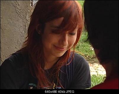

    The same restored frame from manono's srestore video:
    I'm not sure why the levels are different. But I was just performing a quick test so I wasn't paying too much attention to that.

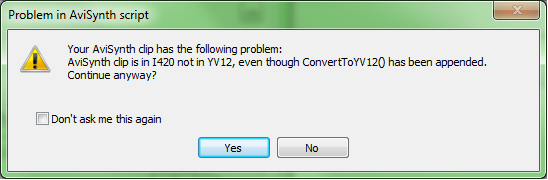

    Also I get a warning popup when I queue up the conversion, I'm not sure if it means it will be a problem or not though. Screenshot attached

  18. greyfalcon - This is a megui bug whenever you use ffmpegsource or ffms2 , but you can just ignore all the warnings as you probably already figured out. (and it's already YV12 anyway)
