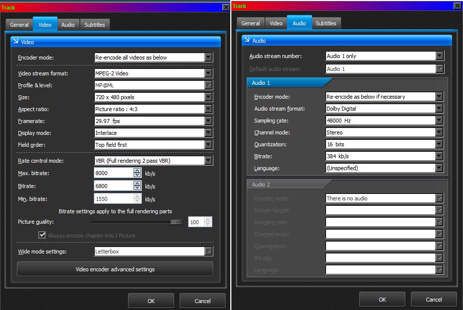

    Well I re-published the film from WMM as an .AVI. Then I imported to AW4...it looks great (has that "live" look I was seeking above) but I now have two new issues. First during transitions (cuts and dissolves), the final DVD's video is jumpy for a split second until the transtion is done, then it is fine. Also, my second new issue, the audio also skips at every clip change or dissolve. I think it's because I encoded in Dolby or something. I've taken a screencap of my video and audio settings I have encoded the DVD with...does anything jump out at you that might cause these mentioned problems in the settings you see in this pic?
Name:	vid settings.jpg

    what type of avi did you use? check it with mediainfo, use the text output. copy all the text and paste it here. the only thing i see that might cause problems would be a field order mismatch, the output is set to top field first, and if it's DV the avi might be bff.

    the cbr of the source has no effect on the taw render to mpeg-2. either cbr or vbr will be fine.
    the only settings i would adjust in taw are the bitrates. use a calculator to determine the best bitrate for the length of the source. for 1hr 48 min including 384kbps audio i would go with:
    Maximum 9000
    Average 5000
    Minimum 2000
    i always go a little low on the ave. bitrate just in case....
    here is one you can use.
    http://dvd-hq.info/bitrate_calculator.php#Calculator

    Hi aedipuss!
    Well I set my bitrates exactly how you have suggested except I am unable to change the minimum bitrate...it is default set at 1550 kb/s and unable to be changed as long as I have it set for two-pass encoding.
    After rendering a DVD using your settings (sans the minimum bitrate); I still get the nice clear picture but the fades and dissolves are even more choppy than before. It seems it's only during the transitions that there is choppiness...not before and not after. So I do have the clear picture quality I sought; just still having issues fixing these transitions. Any other ideas?
