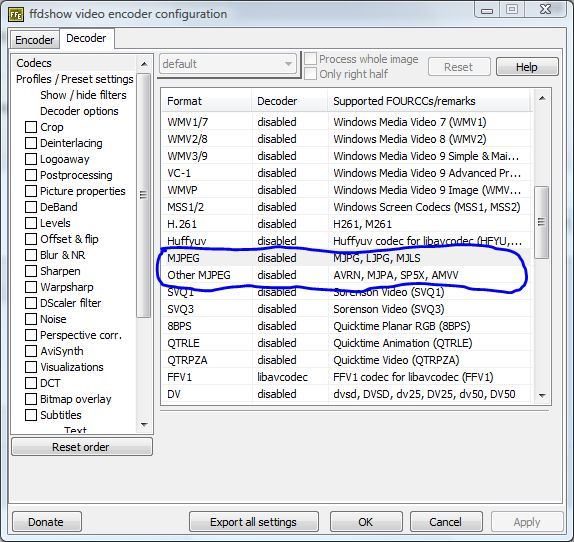

  11. VH Wanderer Ai Haibara's Avatar
    Jan 2006
    Somewhere on VideoHelp...
    In ffdshow's Start Menu folder, check each of the video decoder configurations ("VFW configuration" and "Video decoder configuration"). Select "Codecs" in the left-hand pane of each of the above windows (you may need to select the "Decoder" tab at the top of the VFW window to see Codecs in the left-hand pane).
    Scroll down in the right-hand pane of either window until you find the MJPEG and Other MJPEG entries (under the Format column). For the Decoder column, do they have "disabled" listed, or are they set to "libavcodec"?
