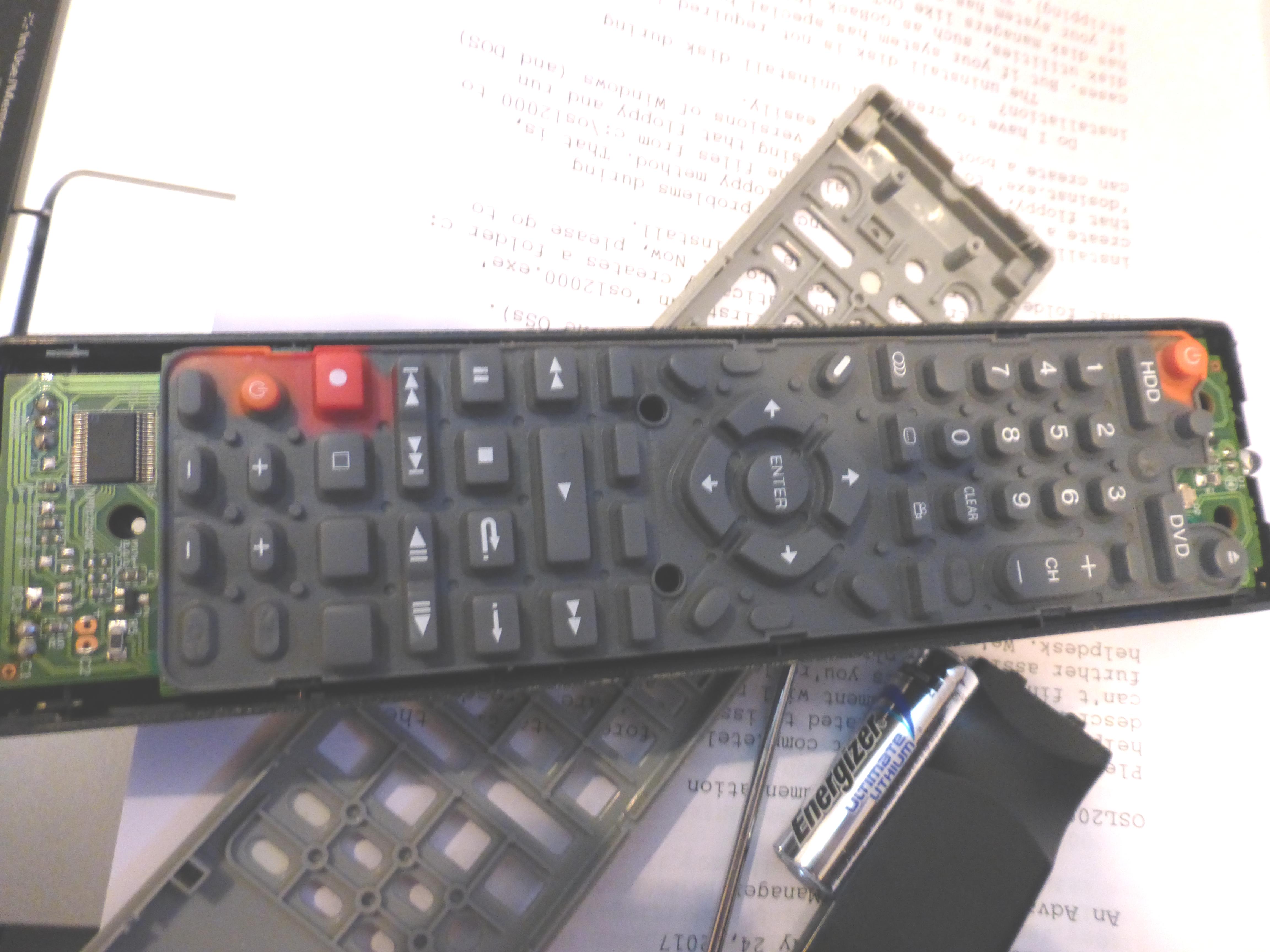

    I have a new question for Orsetto, one he may not have fielded here before. Choosing this thread over some others is kind of arbitrary, but it's still on-topic.
    What would you recommend for a Pio remote that is starting to get flakey, with keys partially sticking or not being as responsive as they should be. (And NO, it was well cared for: I don't bring food or beverage in its vicinity; I've tried to keep it clean.) It's one of the better Pio series remotes: VXX2967.
    I'd prefer to avoid trying to take it apart, unless that's really necessary. Is there some reasonably safe solvent I can dip it in, which would do the job and leave no residue ? I think this remote should be able to have an extended life of good service. And whatever procedure you suggest probably has a relevance for other remotes with such issues.

  12. Sorry for delay in replying, seeker47: I've been traveling all week and just got back.
    The VXX2967 and similar variants were the most ergonomic, intuitive remotes Pioneer ever designed for their DVD/HDD recorders. They were the earliest design, supplied with the DVR-510, 520 and 530 series, featuring large grey buttons of various shapes on a silver background with easily read black labels.
    Unfortunately, as you have discovered, they decay over time and become less responsive. I'm not quite sure where the problem lies when it eventually develops. It isn't that the keys wear out, because they still do work: its just that the recorder becomes less and less responsive to them. Almost as if the batteries were going dead, but replacing the batteries doesn't help. And not all the keys are afflicted: some continue to be the same as before.
    I've tried opening the VXX2967 (etc), and cleaning the membrane/contacts with a solvent. Also tried various other fixes recommended by remote control experts, to no avail. It sounds strange, but the defect seems to be more on the recorder end of things than the remote: as if the recorder decides it "doesn't like" the VXX2967 signals anymore. I came to this conclusion after cycling thru all of my brand new, backup VXX2967 remotes: the recorder(s) that were unresponsive to a worn VXX2967 were equally unresponsive to a "new old stock" VXX2967.
    Yet when I tried the (awful sliding door) newer VXX3129 that came with the DVR-640, all my Pioneers responded to it smartly. The dreadful VXX3288 from the DVR-550/560 also works "like new" with all Pio recorders of any vintage: very snappy and quick response. Its a complete mystery to me why my 540, 550 and 560 developed an aversion to the much nicer VXX2967 version of remote. But they did, so I've forced myself to get used to the newer remotes. Neither is ideal, but they beat dealing with the sluggish response or non-response to the older remote.
    The VXX3129 (and its ilk) were an ergonomic disaster. Small, generic white buttons on a white background, with half the buttons hidden under a sliding door that constantly gets in your way. It was so hated in 2006 that Pioneer replaced it the very next year with the VXX3288 (etc). This had no sliding door, thankfully, but is horrible in other ways. It is too skinny to hold comfortably, the buttons are microscopically small, arranged in no sensible order, and black on a black background (why the hell Pioneer thought black-on-black would be any more legible than white-on-white is anyone's guess). The buttons are so small and closely spaced that its impossible to operate the thing by touch, as you could with the old VXX2967. Also, the search/slowmo signals from the VXX3288 make the recorder behave differently than it does when using the same buttons on the VXX2967 (searching backwards and forwards to find an edit point is very annoying with the newer remotes).
    If you're having sudden weird problems with the good old VXX2967, I'm afraid the only alternative is the crummy newer VXX3288. You could try opening your VXX2967 remote, and cleaning the greasy film off the membrane sheet and contacts. But if that doesn't help, get a VXX3288.

    Thanks very much for your reply, orsetto. I will try cleaning it. Also will check with a barely used spare 2967, to see if this is of a piece with the phenomenon you reported. I'll be a bit surprised if the fault lies outside of the remote itself. (Largely due to the almost-sticking response of certain keys.) In a different location, I have a different (?) issue with another of these remotes and its Pio DVDR: the fluorescent display on that unit has grown rather dim (which I expect is not fixable), and the remote there has become extremely line-of-sight and needing a fairly close proximity to the DVDR in order to work, which is annoying to say the least. No indication of flakey button response there though -- at least not yet.

    Back to the VXX2967. This is where I'm very glad that I'm well stocked with computer tools, including jeweler-type screwdrivers and long needle-nose pliers. I took the cover the remote off and zotzed the innards with compressed air. Not sure yet if that accomplished anything. I expected to find a thin transparent membrane, with some film or gunk accumulated on it . . . but that is not what I saw. (See photo I will try to attach here.) There was nothing much to clean above the grey rubber, just a very tiny speck of dust, which the canned air dispatched. Should I have (carefully) pried that rubber key-section off and cleaned underneath it ? I am reluctant to proceed any further without some detailed guidance. Have put it back together, in the meantime.
    Also in the meantime, I have acquired a VXX3288, as per your recommendation, and I take your point. Forget about touch operation, in the dark ! Besides the small button size, I almost need a magnifying glass to consult that remote. But it worked fine, with both of the Pio DVDRs I previously mentioned. Then, I located a spare, unused VXX2967 I had purchased some years back. (Had I a bit more foresight, I would have bought a couple more, whilst they were still available.) Trying with this seems to be at variance with your theory. Neither Pio DVDR had any problem with it. Not with the off-axis / line-of-sight issue with the second unit, nor per the key response or recognition issues I had described for the primary unit. Therefore, at least based on the current evidence, I'm going to conclude that the fault lay essentially with the well-used 2967 remote I inspected. If it can be restored to good functioning, that is something I'd like to do. Click image for larger version

    The conductive material behind the button(s) is probably worn out.
    Here's a link to electric paint which explains why and how to fix it: https://www.bareconductive.com/make/fix-a-tv-remote-with-electric-paint/ . Look up 'electric paint' on Amazon for a U.S. source.
    I haven't tried it myself, but learned about electric paint (they used to sell it at Radio Shack) because I've swapped out buttons on remotes when one goes bad. Note that only the little black (sometimes white) dot is what makes the connection. The rest of the rubber is just to keep the buttons in place.
    To test before you buy electric paint, swap out the good remote's membrane with the bad one, just to check if it's the membrane or the circuit board is bad (very rare, but I've had it happen).
    Edit: The website recommends cleaning the board with rubbing alcohol. Be sure there's no perfumes or additives (just water and alcohol) and get the highest percentage you can (91 percent is the highest I can find locally). Special circuit board cleaner would be even better, but not necessary. Be sure to let the board completely before touching it or reassembling, especially if you use a high percentage alcohol as it can soften the coating on the board (leaves fingerprints).

  20. Originally Posted by Seeker47 View Post
    Yes, if there is a physical malfunction you will find it underneath the rubber key sheet. In my experience opening a dozen of this era Pioneer remote, there is a slimy/greasy film between the bottom of the key sheet and the contact board beneath it. Whether this is a required conductive assist that decays over time, or a byproduct of the key sheet outgassing or decaying, I haven't been able to determine. I've tried cleaning it off per lingyi's suggestion, and it didn't seem to hurt anything, but cleaning it off didn't help either: the unresponsive keys were not improved in any way. I never tried to reconstruct the contact materials with electric paint, because in every failing VXX2967 remote I've opened the contact stripes seem completely intact. But perhaps looks are deceiving and lingyi's advice to try the paint might work even if there doesn't appear to be any visible damage? If you do try this, seeker47, please report back and let us know the result.
    As to your backup, like-new VXX2967 working fine vs mine suffering the same issues as my well-worn remotes, I can offer no explanation. Perhaps all my Pio remotes of that vintage have decayed simultaneously, whether in use or storage. Or all my recorders suffered some sort of IR receiver anomaly (power surge?) that render them less responsive. Its very odd, and very frustrating, that only the desirable VXX2967 seems to develop issues (while the terrible later remotes are bulletproof).
    My VXX2967 problems are always the same: the fwd/reverse speed search buttons go first, then the chapter skip buttons become less and less responsive, then finally the CM Back & Skip buttons (of course, all my primaries). I've noticed that with the newer remotes, there is a subtle but distinct difference in how those same buttons interact with the editing screens: the functionality changes (i.e. in the scene delete system, if a video reaches the end of its timeline it will ignore the reverse search button until you use the reverse slow button to back a few frames away from the end). Something is definitely altered in the signals from the newer remotes, because the recorders (old and new) do tell them apart and respond accordingly. Maybe the newer signal is stronger somehow, and the button contacts less subject to failure.

    There would appear to be much worthy of investigation here, per the last few posts.
    I would note that although the product lingyi mentioned -- and I had never heard of this before, although very possibly you had -- is a U.K. product, it does have U.S. resellers listed. That should make it easier to try out.
    As far as which were the more problematic keys on my 2967 in question, they seem to differ from what you were reporting. I think the scanning FFWD & F/Rev keys do have their issues, but I was mostly noticing the sticking or lack of proper response from several basic Alpha keys, as when I would enter or edit Titles info. It got to be frustrating, having to press a letter key or the Space key several times, before it would register. I'll need to check on how that compares with any problems of the (less frequently used) downstairs remote -- which could even be a Pio 640 remote, I don't recall offhand.
