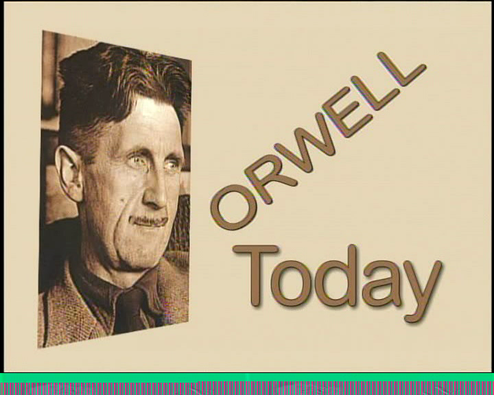

    Now it's encoding, however, the output file has a strange green bar at the bottom of it with some weird colored lines below it (see attached picture). Otherwise it looks good though and sounds fine. Now the error code reads:

    Problem solved. I don't know why it took me so long to figure this out.
    For anyone else that runs into this issue with the green bar and other errors.
    Step 1: Check that the "invert mapping" is checked on the audio tab.
    The default video size, when set to 16:9 was 720x480. When I adjusted the aspect ratio to 4:3, which changed the video size to 720 x 544. Therein was the problem.
    Step 2: After changing the aspect ratio to 4:3, I manually changed the video size back to 720:480 everything worked again.
    I'm a bit of a novice, so not sure if this is useful or just me tripping over my shoelaces and documenting the fall. At any rate, I hope this is useful to someone out there.
