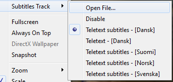

    Recently I bought a new TV with a PVR function. Recording outputs a .ts file to a USB device. When I try to play the .ts file on my computer audio and video are just perfect, but I am missing the subtitles.
    I use VLC for playing the files and it detects the following subtitles:
    But when I select one of them no subtitle show up.

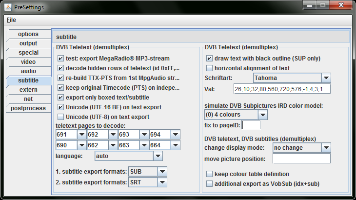

    The subtitle settings looked like this:

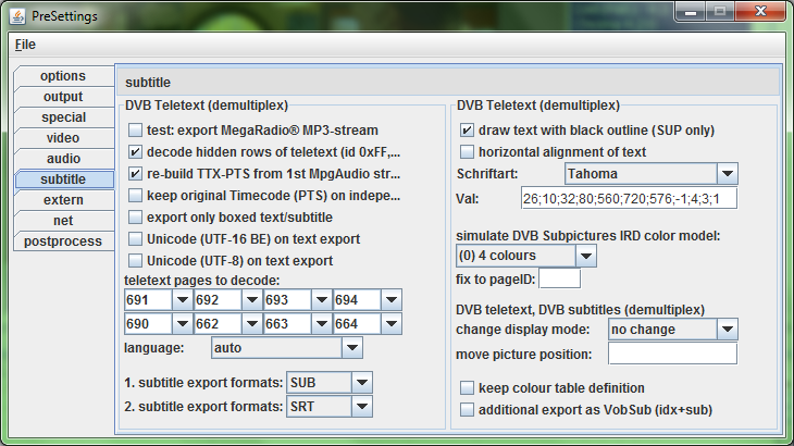

    I just tried to set it up according to the guide in your signature, but the output is the same (M2V and MP2).
