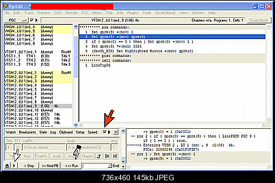

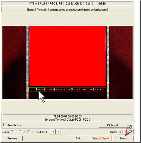

    I am still waiting to download files. For now I will send you few pictures for you to see how to make a file play.
    In picture #1
    Check the box marked with red arrow, than press "RUN",
    Scroll will stop and play every video. Once you get to a menu, highlight button you like and press "Select" picture #2. Scroll will continue.
    Once you go through all the menus and start a movie play, scroll will stop at the beginning of Title and start to play.
    You have to press "Close Preview" at any cell because it will stop there at the end of cell play. Once you do that it will go to next, or start scrolling if there is only one cell.
    After movie is done it will return to a menu. I cannot tell which one, because it depend how DVD was programed.
    I really think that what you have done so far is OK and it will work.
