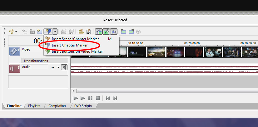

    In and out points are for segmenting a single clip into smaller clips for isolated playback. Real chapters are simply markers along the time line. I only have 4.5 Pro as a reference, but what you need to do it open the title on the timeline, then click on the Marker tool and hold to bring down the selection menu. Select Insert Chapter Marker from the list (See image)

    On the timeline, place the cursor at the position you want the chapter, then click the Marker tool to place a chapter mark. Repeat until all your chapter points are in place.

  7. I got that far before, but I couldn't get my button to link to the corresponding chapter. I'll try again in a minute, I'm authoring something else right now.
  8. Thank you so much, guns1inger. I got it figured out. And in typical fashion, as soon as I did figure it out, it was so freaking easy.
