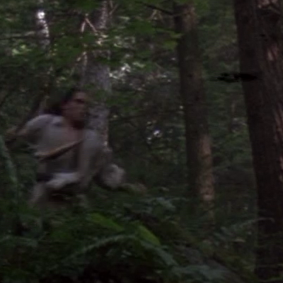

  25. DgAvcDec shows many problems with that clip. But ffdshow decodes it correctly (just a few black spots here and there). I think this means it uses PAFF and/or MBAFF. Meaning it's encoded progressively but some frames (PAFF) and some macroblocks (MBAFF) are encoded interlaced. DgAvcDec doesn't support that.
    I muxed the elementary stream into a TS container with TsMuxer. Then ran DgAvcIndex on it. I opened the file with AvcSource() and DirectShowSource() -- so both were accessing the exact same file. AvcSource() uses DgAvcDecode to decode, DirectShow was using ffdshow. Sample crops:
    AvcSource():
    DirectShowSource() ffdshow decoding:
    Does anyone know of a tool that can parse h.264 streams for PAFF/MBAFF?
