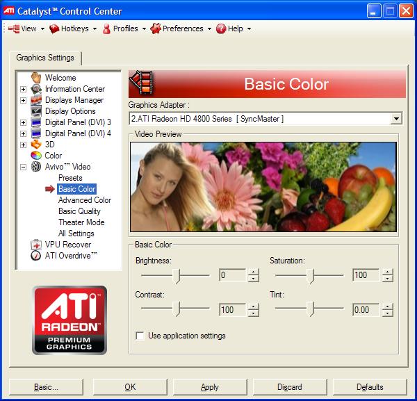

  5. CCC -> Avivo Video...
  6. Originally Posted by jagabo View Post
    Thanks, but I already tried this with no success.. I just couldn't adjust the colors correct no matter what.
