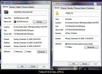

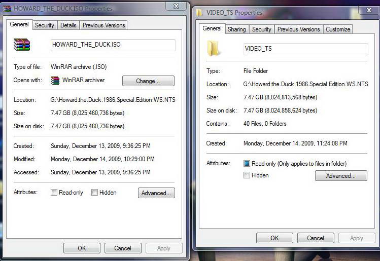

    The difference between my VIDEO_TS folder and ISO is so small it's not even worth bothering to think about....
