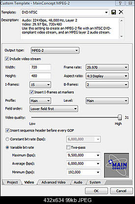

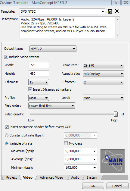

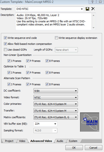

    Ok...here you go. I apologize for not being more specific. I just thought that someone would have heard of what is happening before. I cannot imagine that the settings are wrong, if it burns perfect with one program but not with another. But, then again, I know what happens every time I ASSume.
    The media is Sony DVD-R. If I can figure out how to post a couple of clips, I will do so.

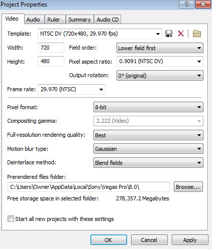

    The workflow went as follows: The original source was created by a production company that I hired. They were using broadcast cams to tape. Then they captured the video and gave me both the raw footage on tape as well as on DVD. Because I did not have a tape deck for his larger tapes, it was easier to just rip the DVDs. The program I used to rip it, converted them to AVI files. I then dropped the files into Vegas and did my editing and then rendered with the settings that I have posted to a MPEG2 file.

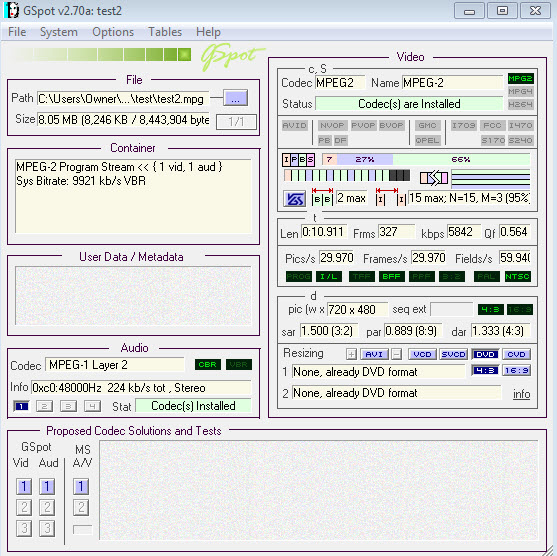

  11. Video Restorer lordsmurf's Avatar
    Gspot the input.

    Is this what you are looking for? I have never used that program before. I just downloaded it and put a sample clip as the source and this is what it spit out.
  13. Not that familiar with MainConcept, but the first thing I would do would be to lower the max bitrate down to 8,000 and test. Brief spikes in bitrate would account for your symptoms. Somewhere around 8,500 to 9,000 should be safe but encoders vary.

    I was looking mostly for the interlacing info from Gspot, and speculated the same as gunslinger did -- field order mismatch along the workflow.

    the original files were DV and I have matched the field order of Lower First. I didn't realize that I had to spell it out on how I tested the lower bitrate file. It seems quite obvious to me. I went into the settings and lowered the bitrate to a constant of 6,000,000 and reburned the file with the same results. and yes I tried it on several televisions.

    You need to post samples so we can diagnose the issues. Field order needs to be set or confirmed in project settings, by clip (clip properties) and in encoder settings.
