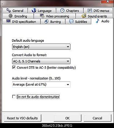

    check the audio options menu in convertx4. you can set the level as high as you want.
