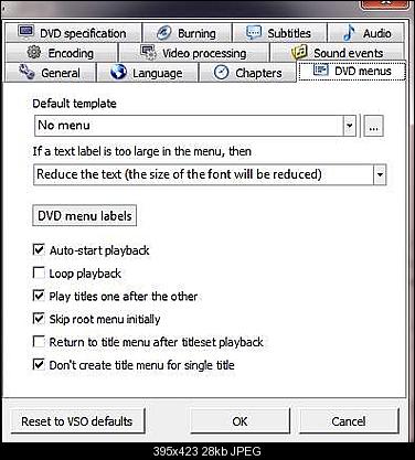

    there are settings that may be wrong. try making yours like these.

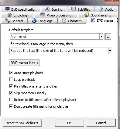

  3. ok will try this as I can see on mine the 3rd box isn’t ticked play titles one after the other. so I guess this is what's wrong. I will let you know if it has worked ok

  8. Originally Posted by aedipuss View Post
    [Attachment 438 - Click to enlarge]
    yes this also worked better too, but guns1ingers way worked even better, but many thanks anyway
