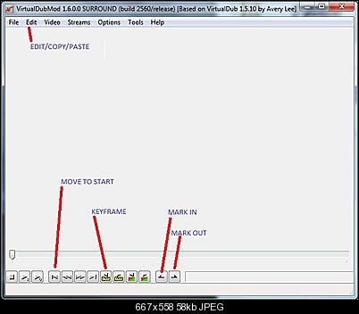

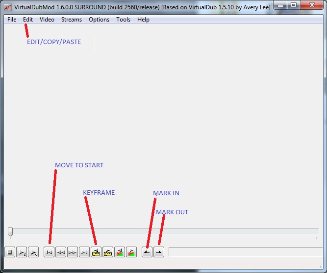

    Depends on your format, but usually the first frame of the video is used for the thumbnail. What I've done in VirtualDub is to choose a keyframe that has the desired picture on it, then copy that and paste it to the beginning of the video. If you can get just a single frame, even better.
    Use the Keyframe key to find a suitable keyframe, then click the 'Mark in' button, then use the KB R arrow key to move one frame forward, then the 'Mark out' button and then the 'Edit>Copy' command. Move to the beginning of the video with the 'Start' first frame key, then 'Edit>Paste' the frame. Save the video in 'Direct stream copy' mode. Use a different filename if you don't want to damage the original file.

    You generally don't even see the single frame displayed on playback, but it should display as the thumbnail for the video. It's similar to adding a title screen to the beginning of a video, but just one frame in duration.
    For MKV, you might have to use AVIDemux, though I haven't tried it for this. Probably other ways to do all this, but I've used the above method for some time with Xvids and other compatible AVI type files.

    EDIT: The arrow is pointing to the wrong keyframe button. It should be the one to the right.
