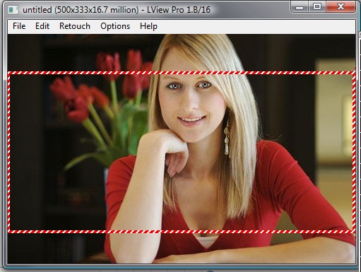

    Or do you want to do this?

    I don't want to crop the image. I only want to add 2 pillars on both sides to make the video look like 16:9.
