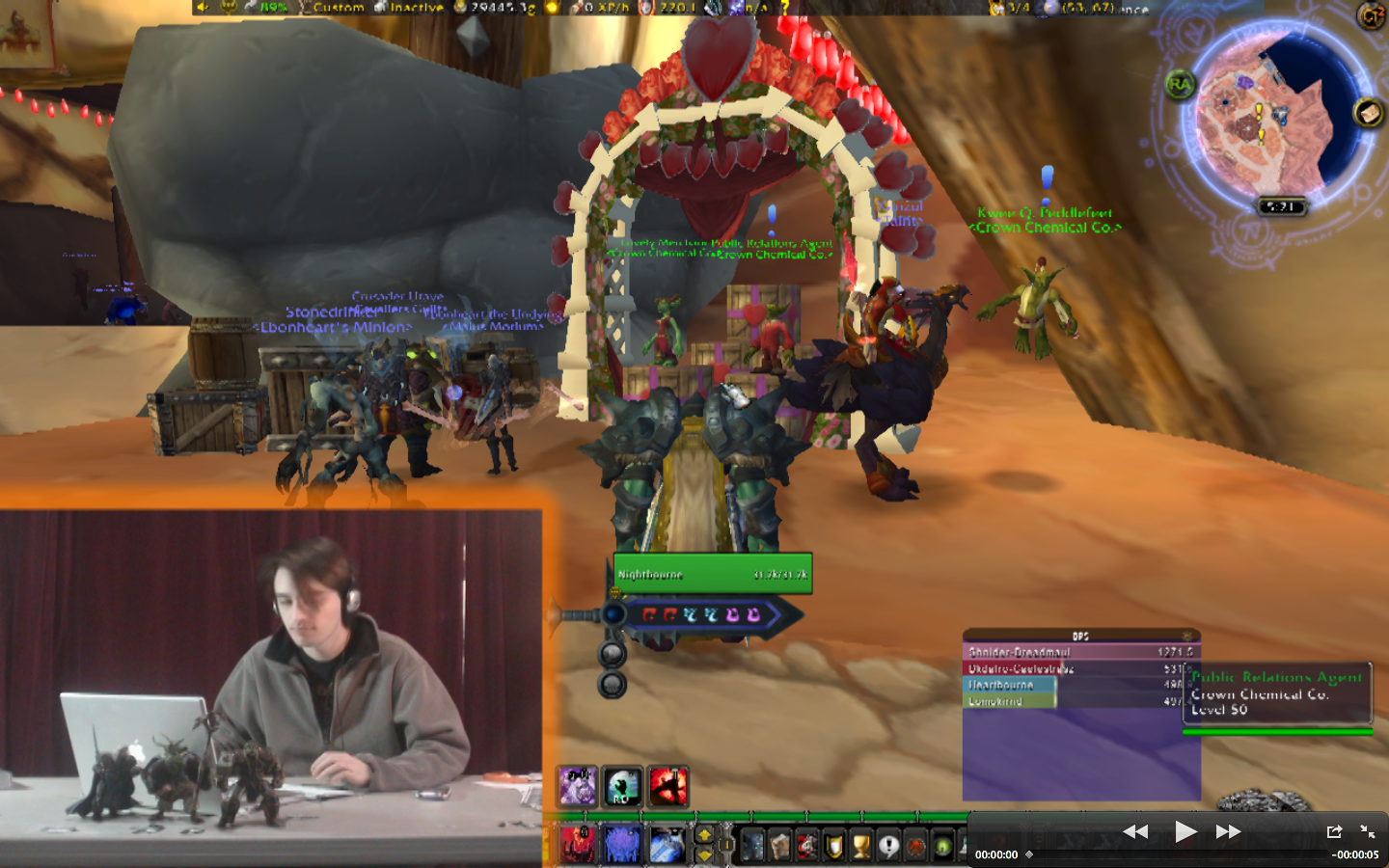

  1. I'm having some issues with Premiere not compressing things very well. I do a web video show about WoW, and the exported video looks awful. I record using the animation codec, and I've tried just about every lossless option for exporting.
    My source:
    Type: QuickTime Movie
    File Size: 36.5 GB
    Image Size: 1280 x 800
    Pixel Depth: 24
    Frame Rate: 31.58
    Average Data Rate: 12.7 MB / second
    Pixel Aspect Ratio: 1.0
    Frame Size = 1280 x 800
    Compressor = Animation
    Quality = Most (5.00)
    Temporal = Most (5.00)
    Output:
    Pixel Depth: 24
    Frame Rate: 29.97
    Average Data Rate: 87.8 MB / second
    Compressor = None
    Quality = Least (1.00)
    I've tried using AIC to record my source video as well. I don't have the hardware available to record uncompressed. I've tried rendered at a bit depth of 24, the source, and max bit depth, and it makes no difference. Optimize stills is on and the quality slider is all the way up.
    Any thoughts?
    Check the attachments for source/output screens
Name:	Screen shot 2010-02-16 at 9.50.23 AM.png
Name:	Screen shot 2010-02-16 at 9.51.09 AM.png

  4. Why are your screenshots 1440x900? Something isn't matching correctly from your sequence setting of 1280x800
    Your timebase is off too, if your source is VFR (variable frame rate) you will have problems. Your source says 31.58fps, which is very non standard. PP CS4 will sample in between frames to make up for the CFR 29.97 sequence settings. The normal behaviour is "blend" clip so you get a blurry mess
    When you capture, you should be using a constant frame rate. What software you are using?
    Why did you use "least" quality for export?
  5. My source is VFR. My screenshots are 1440x900 because thats my native desktop resolution and I just did some quick screengrabs from QuickTime. Is there a way to have it repeat frames or something instead of doing blend?

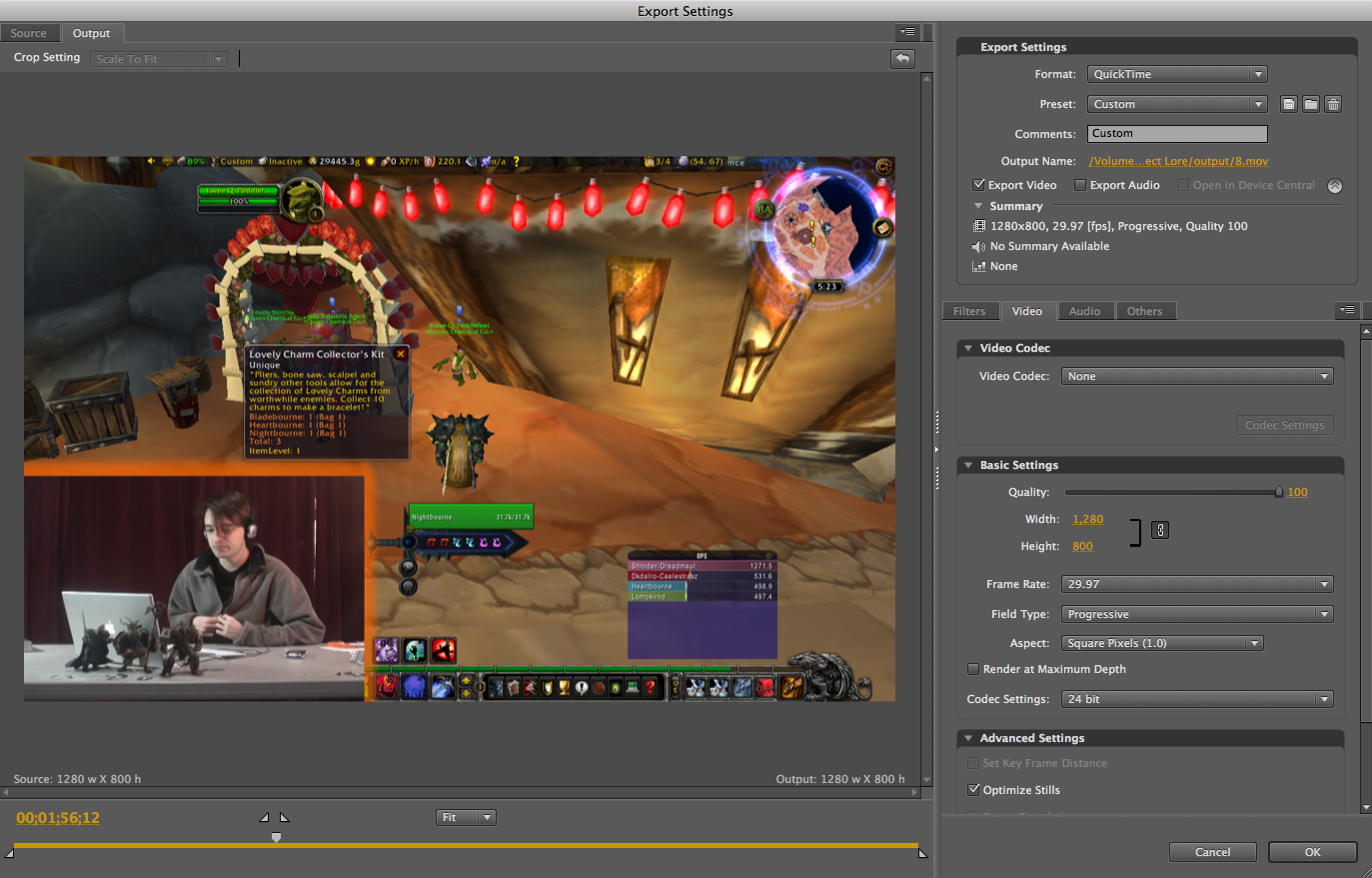

    I uploaded a screenshot of my export settings.
Name:	Screen shot 2010-02-16 at 10.22.45 AM.png
  6. This won't be ideal since the timebase is 29.97 CFR. PP doesn't support VFR, so you will get sections that seem sped up, and sections that slow down, and the transitions might be jerky depending on how variable your acceleration/deceleration rates are . The normal behaviour is "blend" so it will subsample by blurring foward and backward frames with the intent to make things "smooth". If you disable it, playback will be more "jerky"
    With the clip selected, clip=>video options=>uncheckmark frame blend
    I would also try raising quality to max instead of lowest upon export
    Your distribution format is unlikely to be RGB444 (more likely flash h.264 or some 4:2:0 YV12 format) , so you could export reduce the filesize substantially by exporting a lossless YV12 4:2:0 format. Unfortunately there are not very many lossless compression choices on Mac, lots more on PC like lagarith, huffyuv, UT, FFV1, MLC, etc... most of them will offer about 1/2 the size of animation or uncompressed. (I think there is a huffyuv mac variant)
