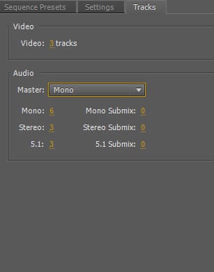

  22. i import movie in premiere pro but...
    i can't move audio track
    i want to transfer "audio track 7" to "audio track 1"
    http://img4up.com/up2/36701417629134585388.jpg
    Welcome to the Hotel California
  23. Originally Posted by Sheibani View Post
    Just click and drag it . Make sure tracks aren't locked . Your screenshot doesn't show audio track #1
    If audio track #1 doesn't have matching channel configuration, it won' t let you. (E.g. 5.1 vs 2.0) . Then you would need to set up your sequence settings properly in the first place
  24. I can't drag it...
    Screenshot
    http://img4up.com/up2/99642368869673472584.jpg
  25. Originally Posted by Sheibani View Post
    The channels don't match
    Audio 1 is a stereo track. The audio on Audio track 7 is mono (notice the speaker icon, is single, not double)
    Did you read this ?

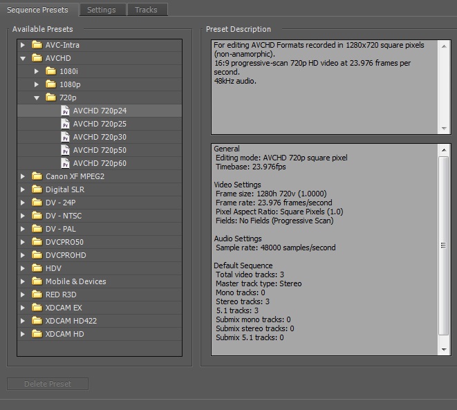

  26. ٍExcuse me
    for editing, i chose the right?
    Do you think I got the best Preset?

  27. what is your export goal?
    your video is cropped 1920x816 (no letterbox), so there are no presets for that
    use a custom sequence setting to match 1920x816, 23.976 fps , square pixel - go to the general tab, editing mode: desktop, timebase 23.976, 1920x816, PAR square pixel, fields progressive - basically match all the settings to your input video . (When you export use similar settings, assuming you want the same type of video) .
    Master audio should be 5.1, because your source is 5.1 . The other settings only matter if you are mixing other tracks
    how did you import the video? re-wrap into mp4?
    what type is the audio? AC3? DTS? from your other screenshot, it looks like you are importing mono channels individually, not a 5.1 single track. Is there a reason for that ? You might have to import audio separately e.g. mkvextractgui2, then import audio separately

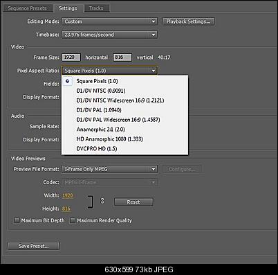

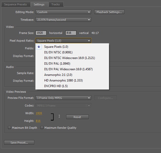

  29. Excuse me, Which aspect ratio do I choose?
  30. Originally Posted by Sheibani View Post
    Please read the previous post more carefully:
    You didn't answer the other question, but if your export goal was something like blu-ray, you need to use different settings (cropped size is not compatible, you need full frame letterboxed 1920x1080)
