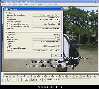

    It says 29.97 fps when I open the "Anno clip 1.mp4" you supplied a while back. What frame size does it say? I get 708x480:

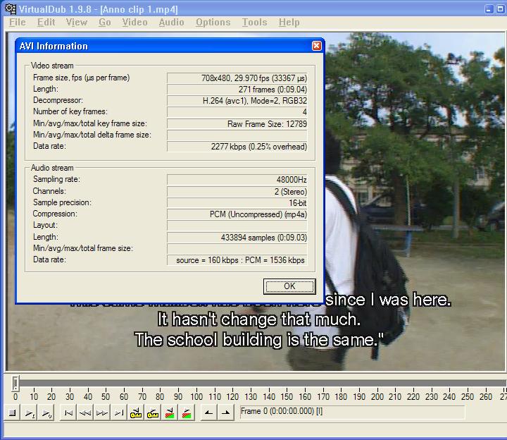

    Well This is what it says for the full video when I open the script. Does the file just need to be saved after opening the script in order for the changes to take effect?; because the ETA to save the full video is 16+ hours.
Name:	Anno vid tempgauss.jpg
  12. Yes, just Save as AVI. Be sure to select audio and video codecs if you don't want a huge uncompressed AVI file. But with that 25 fps frame rate you'll probably get A/V sync errors. Adding AssumeFPS(29.97) to the end of your script should fix that.
