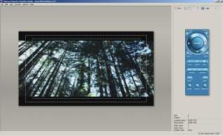

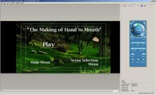

    I'm building a DVD of proshot material that I believe is all in 16:9 (not HD) and I'm having trouble getting it to preview (and subsequently play) in widescreen format. In other words, my DVD Arch project is setup widescreen and during preview, my menus (with still backgrounds) look great and fill a 16:9 box. However when I click on the buttons and play a file, that box changes to 4:3 and the video has black bars on top and bottom. These are straight vob files taken off of original DVD masters for each individual video.
    For example, here is my menu screen:
    And this is what happens when I play a file:
    See how the box changes and consequently, the video output? I've also found in "media properties" (while not in preview mode), that I can change the aspect ratio of the file to widescreen, but that only squashes the output, leaving thicker bars on top and bottom, and the same size, 4:3 box.

  18. I don't use DVDA, but it looks like your project settings might be off. It's not the media properties you want to change, but the way the DVDA project deals with video. I'm thinking something like the project is set to treat video as pan&scan and/or letterboxed instead of widescreen.
    Don't use IFOedit to fix that!
  19. @Nic,
    Hmmmm, I've got video format set to NTSC widescreen, which is under the disc properties tab within the project properties. Seems like that should do it, no?
  20. Your source is clearly widescreen, but the display safe area (the dotted line box) is definitely 4:3; so, it must be a DVDA setting. You have your project set to widescreen, but it's not doing it, why? I'd say there's something else that's set to 4:3 or pan&scan. Rummage through all the settings and look for anything that's related to aspect ratio, it might even be in the program's preferences. Try to start another project and go through all the steps one by one to see if you might have missed something the first time.
  21. Cool, thanks for that feedback, which makes sense to me as well. I'll rummage deeper (I've been rummaging ) and see what I can find.
  22. nic,

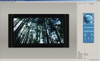

    I've rummaged and have found nothing new. However, I just replaced one of the suspect files with a different version, an mp4 (compressed) and it seems to retain the 16:9 shape within preview! That means that it's the file, no?
    Here's the mp4 in preview:
    However it doesn't fill as much of the black box as the menus do. I'm not sure what that means.

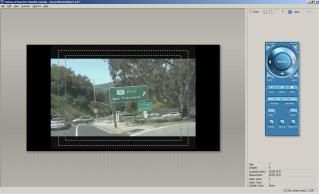

    And the same scene off the vob file:
    I would just simply use the mp4 but the vob looks better. How do I display widescreen as such on my DVD??

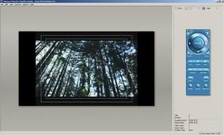

  24. I demuxed with rejig (not really knowing what I'm doing) and restream liked that file. I simply changed where it said 4:3 in restream to 16:9. When I plugged that output file into DVDA, it now previews in widescreen all the way across which is great, but it's slightly squashed (unacceptable, circles aren't perfectly round) and there are still bars on top and bottom. Here's a screenshot to compare:
    I know it's not obvious in this shot, but it is squashed. Am I making sense? I'm feeling pretty confused about this!

    If the source was badly resized during encoding then it won't matter what flag you set, the image will not look right. As much as I love Vegas, I won't touch DVDA with a barge pole
