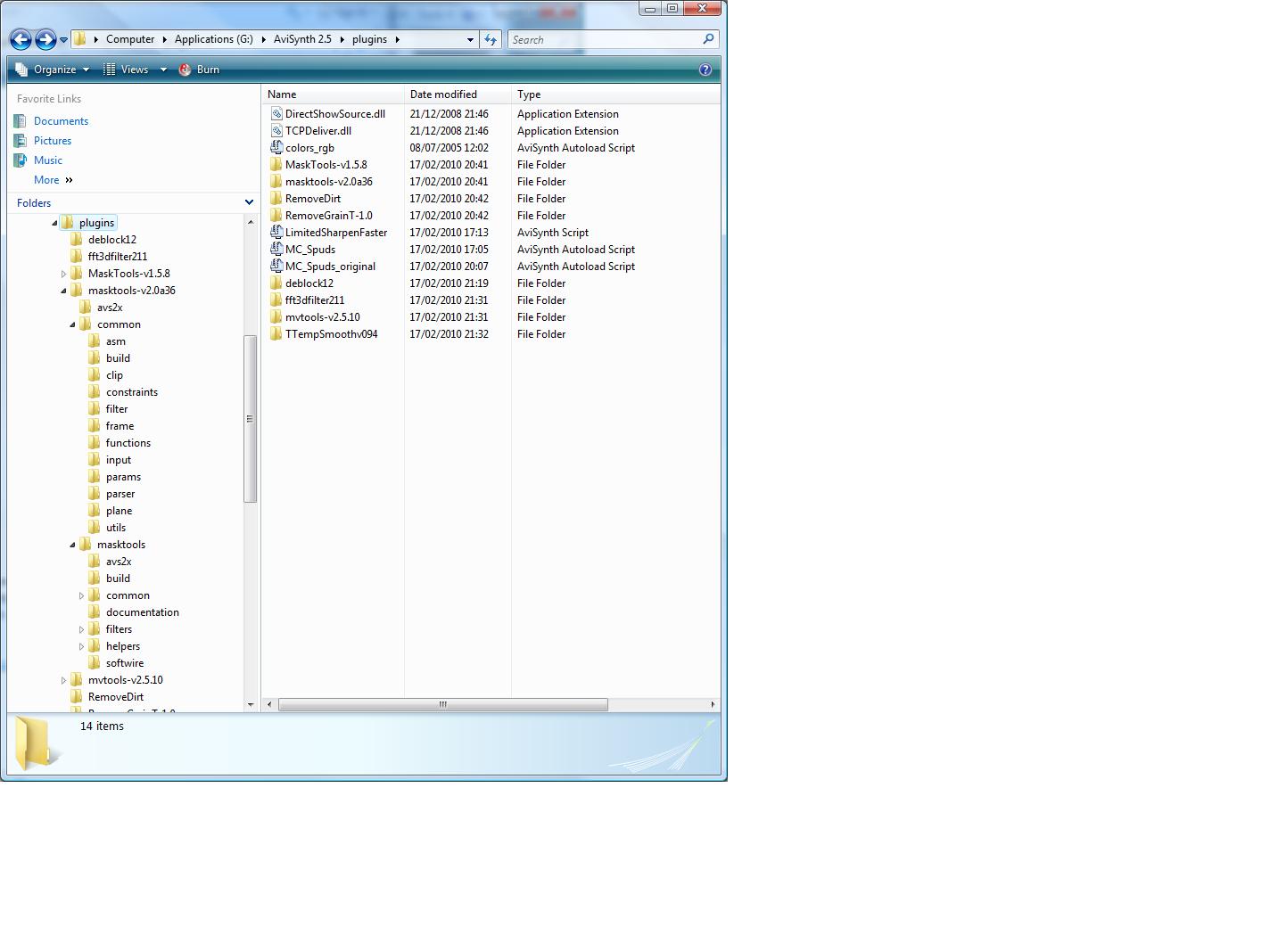

  4. starting to build the plugins folder ... most of these have been groups of .dll files. with a couple of .avs or avsi files.
    If a plugin has a group of 'dll' files can I drop the complete folder of them into plugins folder or do I need to copy across just the 'dll' files.
    On some when I unzip the pack i.e. masktools-v2.0a36 it creates some dll files and also sub folders with H files, is it correct to drop the complete contents i.e dll's and the folders in the Plugin folder in AviSynth ?
    Or again can I drop the complete unzipped folder with all it's content & subfolders into the plugins folder ?
  5. In case my text is unclear .. I have got hold of each filter pack .. once unzipped most craete a folder with a number of dll files .. some have multiple sub folders.
    Am I OK to just drop the unzipped folder into the Plugin folder .... which shows for example currently the pic attached:
  6. Member 2Bdecided's Avatar
    Nov 2007
    The dlls need to be in the plugins folder.
    Any avs files that contain functions need to be renamed to avsi (to autoload) and put in the plugins folder.
    .h, .c etc are all source code - you don't need these. Won't do any harm if you copy them over.
    IIRC things in subfolders in the plugins folder _won't_ autoload - so make sure all dlls, avsi are right there in plugins. (I could be wrong about this - can't hurt!)
    Hope this helps.
    Cheers,
    David.
