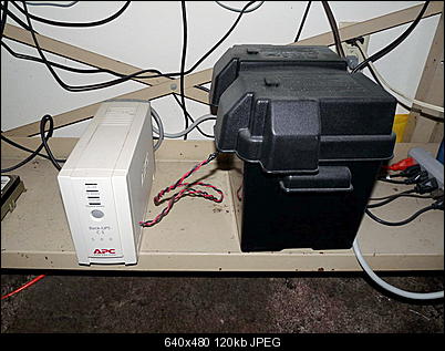

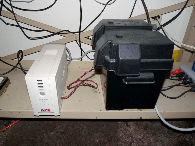

    Jan 2009
    Haven't heard anyone suggest this method. I use a standard small UPS, the type good for about 15 minutes.
    I take out the small 12v 7AH battery and connect wires & run out to an external heavy duty 12V deep cycle
    marine battery. To be honest I don't know what the run time is. It's has on one occasion run over your 4 hour
    requirement. This is on a fully loaded PC + 19" wide screen monitor.
Name:	UPS with external battery.jpg
