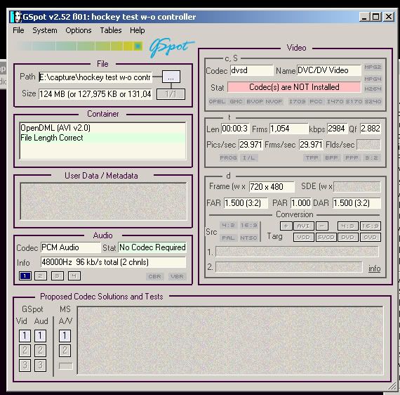

    I used to use an old Avermedia Studio card in my old Socket A (MB) computer. It captured pretty good (actually) but don't edit that footage. As soon as you start to edit it, you just lost like 50% quality. Like going from a master copy, to 3rd gen EP recording. I was using Pinnacle 8 at the time, and I got up to Titainium 10. I gave up on Pinnacle by then. I was still getting quality loss as soon as I did editing. I don't use this anymore
    Back On Topic: So then (with my modern equipment I first listed) the first tapes I actually did, I did straight recording, and no editing. when the scene ended, I stopped recording and that was one footage or chapter. Get enough for about One hour, and then burn it like that. Results not too bad, but I figured there must be better ways of doing this.
    So, with info overload, and two years of reading forums and discussions, I gave up and started asking: Maybe I've got some setting wrong, or I'm using the wrong codec (Nothing I read tells me what I need to know) or it is being compressed when I'm trying to avoid compression, Or maybe something is being De-interlaced, I don't know that the software is doing it, or maybe I don't have the right resolution set.

    Here's the info from G-spot: (if the image comes up...) I took the settings from Lordsmurf's site with the S-VHS function settings.
  30. Video Restorer lordsmurf's Avatar
    Your attachment didn't attach.
