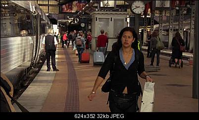

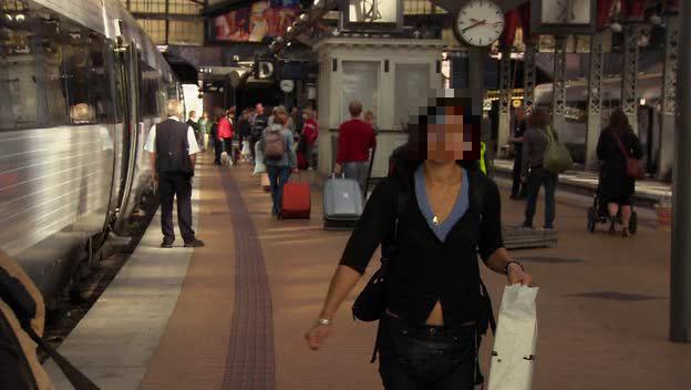

  7. Pixelate face:
    AVISource("filename.avi")
    blur=Crop(370,80,64,64).PointResize(8,8).PointResi ze(64,64)
    Overlay(blur,370,80)
    before:
    after:
    You can use BilinearResize() instead of PointResize() to get blurring rather than pixelating.
