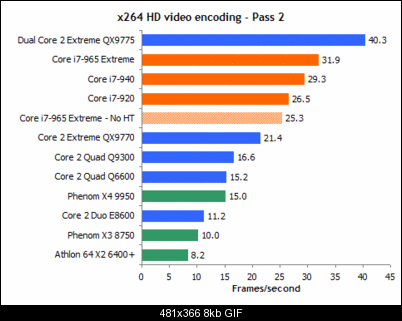

  11. HT is useful in some applications. It depends if the software can use it.
    In the case of i7 and x264 CLI, HT on increases FPS by ~30-40% over HT off (assuming no other bottlenecks), and is definitely advantageous. These results have been reproduced by dozens of review sites (not just me). In some applications, such as games, you actually get lower performance by a few percent!
    You usually see about 1.5x performance with applications like BOINC and HPC computing where an entire process is spawned per thread

    Not so, hyperthreading destroys x264 results
    While benching x264 we noticed enabling Hyperthreading does hurt the results considerably
    Google turns up 1,000's of other discussions on the same subject.

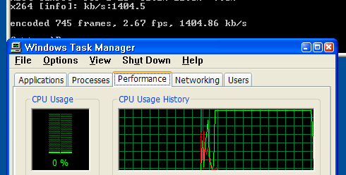

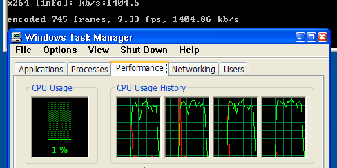

  15. Seriously , I can't believe you're even questioning this... This is one of those well known facts in the video world, x264 scales very well in the absence of bottlenecks (bottlenecks could be anything from source filter, avisynth, encoding settings etc....) . That HD test should scale well on any computer to at least 8 cores (I've tested it on my dual quad workstation to 8 )
    Yes, 99-100% scaling means 5fps at 1thread, 10fps at 2threads etc...(EDIT: sorry, I mean scales linearly with physical *cores* , by default x264 uses threads*1.5)
    Deadrats - You're not going to believe me until you do it yourself. In the bios or msconfig bootup you can disable your cores. Do the tests at 1, 2, 3, 4 etc. I've done this exact same thing a year or two ago, like you I needed proof for myself. And as you know, I 'm probably even more of a sticker for proof than you.
    Have a look at the spreadsheets, they haven't even been updated to include 100's of new reports from dozens of different forums, but I think there is enough sample size to see the very very clear trend. There is a big ass thread here and dozens of other forums posting their results for encoding, including here.

    OK 2 birds , 1 stone, from the TechReport review of the i7: HT only added about 26%, but it will vary depending on many factors. Personally I've seen as high as 40% on/off (as have others at Doom9) and as low as 10%. Never slower in x264 (but as mentioned earlier, some apps do get slower with HT a few %). Most these review sites use non i7 patched builds (they don't implement the recent speed increases which offer ~8-10%)

    i know the option you are talking about, in xp it's listed as /numproc, it's present on vista and i'm guessing win 7, but all it does is specify how many cores the OS can use during boot up, try it yourself
    It works for me. I've been using it for years. The difference in performance is obvious.
    NumProc=1, x264 --threads 6
    NumProc=4, x264 --threads 6
