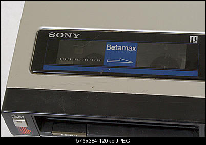

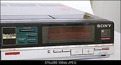

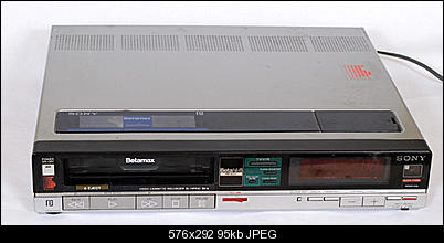

    Oh I suppose I should either do this myselfie or try asking My Parents if they know anyone who has any knowledge about this alsosies I *think* that this is the model informationsie: Sony Video Cassette Recorder SL-HFR30. My Parents got this Betamax in 1984, heehee ^-^
    I found some pictures online of my Beta player! ^-^
