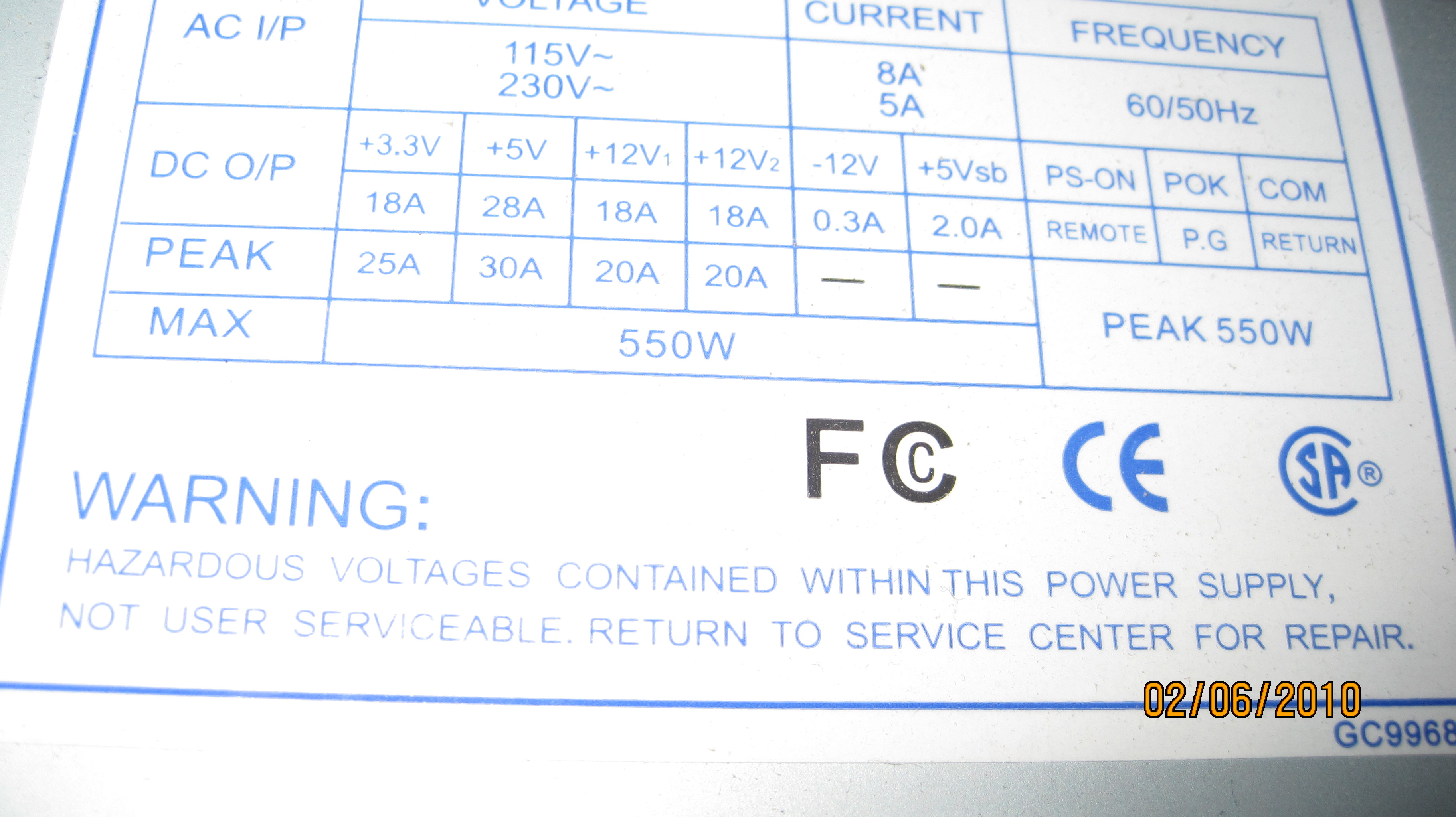

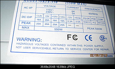

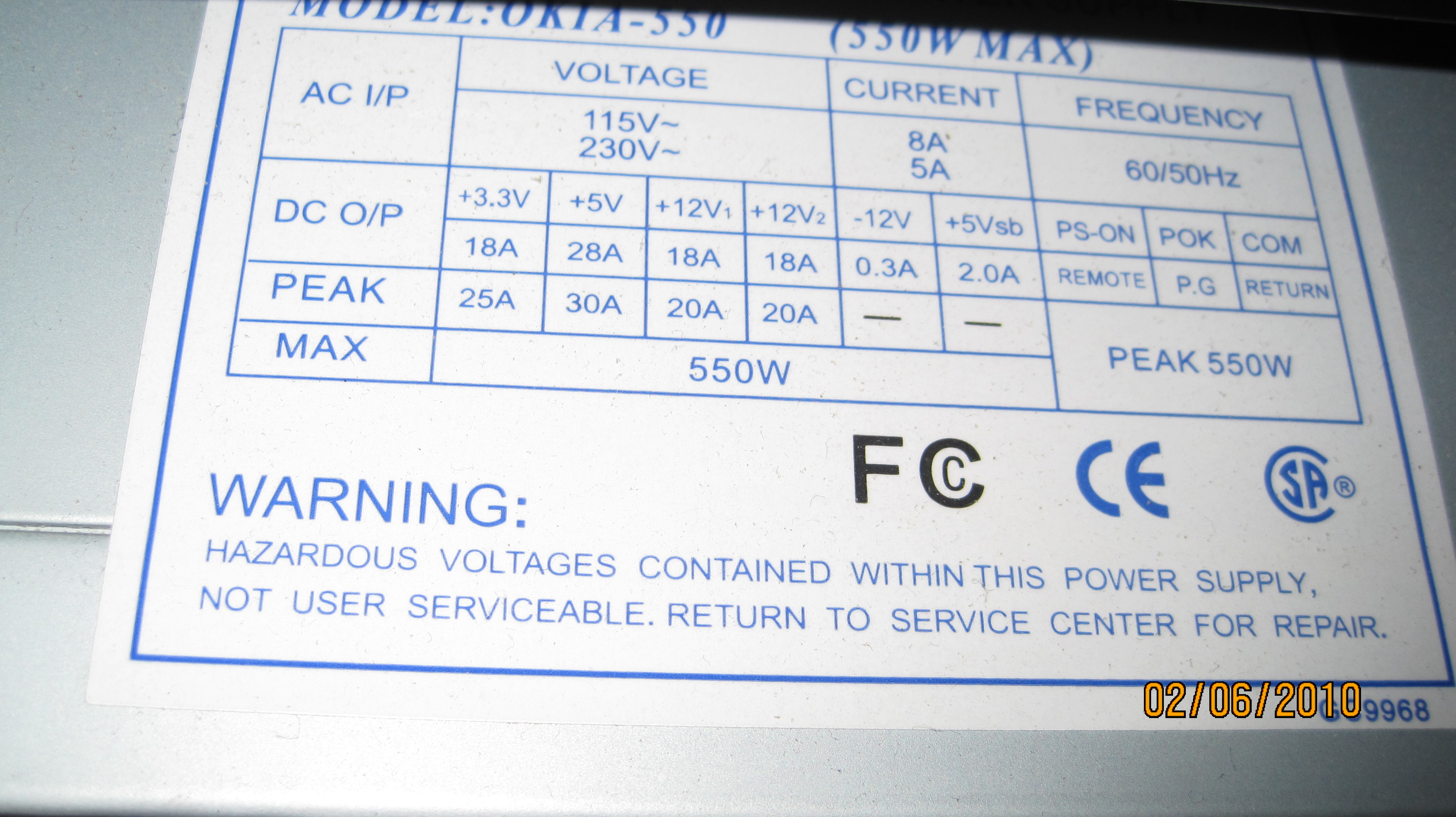

    No link for power supply but I got the best picture I could without having to remove it.
    I have whats required for
    the dual 4-pin peripheral to single 6-pin PCI Express power adapter but I think the 12V current rating of 38A or more may have me beat... I don't know much about power supply's but it seems that I have exactly what is required. I'm not sure if it will be ok since I have two cd/dvd drives, a pretty large heatsink/ fan, quad core, and the other computer essentials.
    Please tell me I'm wrong and this will work for me. I'm not looking forward to having to spend more money for a PS.

    Just an update on this:
    I got my GTX 260 and did the install, no display.. Called tech support (which was great) and figured out my PS is not hefty enough for this card after all, just what I was afraid of.
    He helped me figure out how to read a PS ( I didn't know much about them) and I guess you look under +12 1 and 2 and add the amps or A which were 18A and 18A if you look back at the pictures. That adds up to 36A and the card required a minimum of 38A and apparently a minimum of 550 watts have to be supporting those 38A but the 550 watts are divided throughout the PS.
    No worries though, 700 watt is on the way and I hope this helps someone
