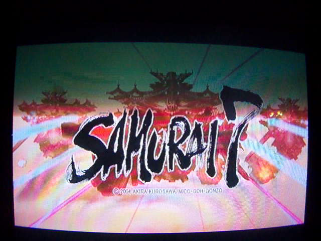

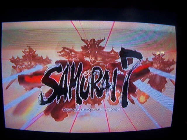

    OK I have a strange question to ask.
    I have a video I encoded at 640x360 with a 16:9 resolution that when played doesn't fill the screen on the left by a 1/2" in the middle and up to 3/4" closer to the top. But when I do a 688x384 at 16:9 it fills the screen like the DVD does and looks fine.
    I tried to take a snapshot of the screen but it really didn't work.
    Maybe it is just me but even my 640x480 encodes look weird on my 36" tv. Being they have a curve on the left hand side only, but not anything else.

    My TV just hates anything in the 640 region. I go to 656x368 and it fills in nicely. The pics do not show what I was seeing. but I guess with a TV nearing 10 years old should stop complaining.

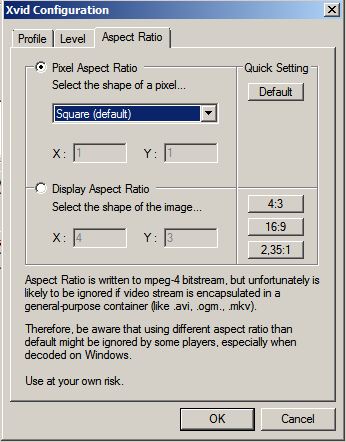

  7. If you're encoding stuff that you plan to watch again in the future - don't worry about the peculiarities of your current player. Also, be sure Xvid is set to square pixel if you are resizing the frame for square pixels. That is, if you resize a 4:3 DVD to 640x480 you are using square pixels.
  8. Member craigarta's Avatar
    Jun 2001
    Cascade Mountains
    If by this screen yes
  9. Yes, that's the right place. I guess your current player just has some peculiarity in the way it scales the video to fit the screen.
