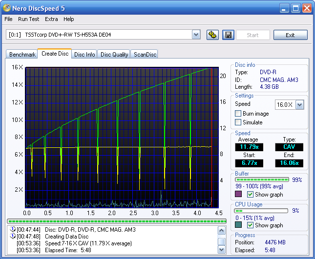

  6. this is the Nero DiscSpeed info while writing on a DVD-R...
    the speed is jumping around, but notice the buffer remains constant. i'll probably be getting a new burner soon, but what do you make of this chart?

  11. Video Restorer lordsmurf's Avatar
    You're using bad DVD media -- CMC is low quality and crappy.
    For a list of what to use -- and not to use -- read the blank DVD quality guide.

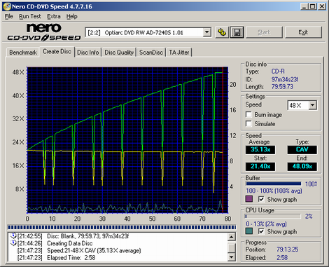

  13. while searching for a new drive, a came across a very positive review of the Sony Optiarc AD-7240S (which is the leading model sold at newegg)
    BUT... in that review, the drive showed a very similar DiscSpeed pattern as my current drive. so, i'm holding off right now on buying a new drive. i'll be looking into any nero buffer issues AND checking out if i like imgburn and it performs well i.e. no buffer weirdness. please keep posting any info related to this thread, it's a big help!

    as already mentioned using crappy ass CMC discs which is your problem....it's not the drive...
  15. yeah, my future spindles will be verbatim, regardless, but are crappy discs often responsible for buffer fluctuations? moreso than nero?
