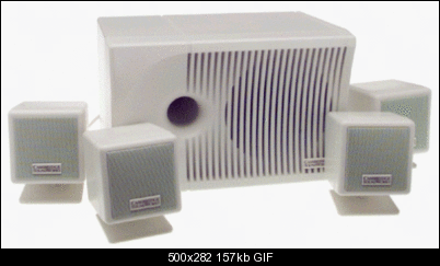

    I have these speakers

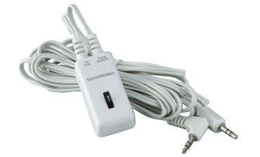

    I'd like to run both my wife's and my own computer to this one set. I have 2 of these Multimedia Volume Controls, one for each pc.

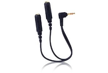

    Now i tried to run both controls to the back of the speaker by using a headphone splitter cable, Name:  pRS1C-2801065w345.jpg

    but having both computers volume controls plugged in this way caused a humming/hissing sound. So is there some way I can use both pcs on this one set and still have each use there own volume controls?
    I tried plugging her volume control from her line OUT to my line IN on pc, and it seemed to work fine (no hum/hissing), just needed to adjust the line in vol. But the problem is, if I have my volume turned low then even if her volume is @ max, she can only go as loud as my pc is set at (making her go to my computer to turn up the vol). So what I'd like to do is some how directly run both volume controls to the single input in the back of the speaker itself. But everything I've tried I get the humming/hissing? any ideas?

    If the speakers have RCA connections all you need is a pair of RCA "Y" connection cables from the speakers to the computers, I am currently using that setup. You need to have 2 connectors shown in picture 4 connected to the "Y" cables.
