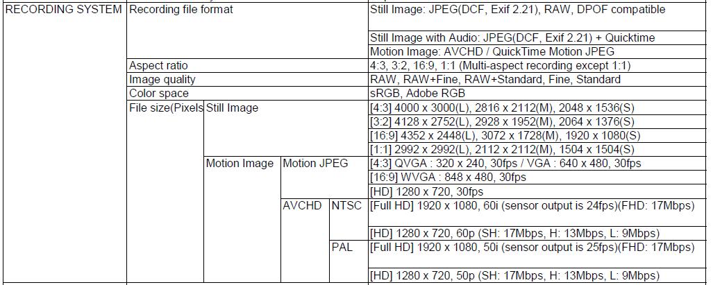

  15. here are the recording formats for the GH1.
    I'm recording in AVCHD 1280x720 NTSC HD mode which is 60p.
    It will record Full HD but in 60i or 24fps.

    I was curious and looked at the files that multiavchd created. the *.m2ts files. they are still in the 59.240FPS yet
    the JVC is able to play it. This is interesting since I thought it converted it to 30fps. will have to look into it further.
    maybe I don't need use to multiavcdhd after all, just the file structure needs to be correct(?)
