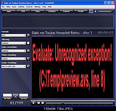

    Can you post a screenshot from Xvid4PSP when this happens ? I suspect that you are actually seeing an avisynth error message, but as you won't actually tell us what is happening, it is hard to really help you.

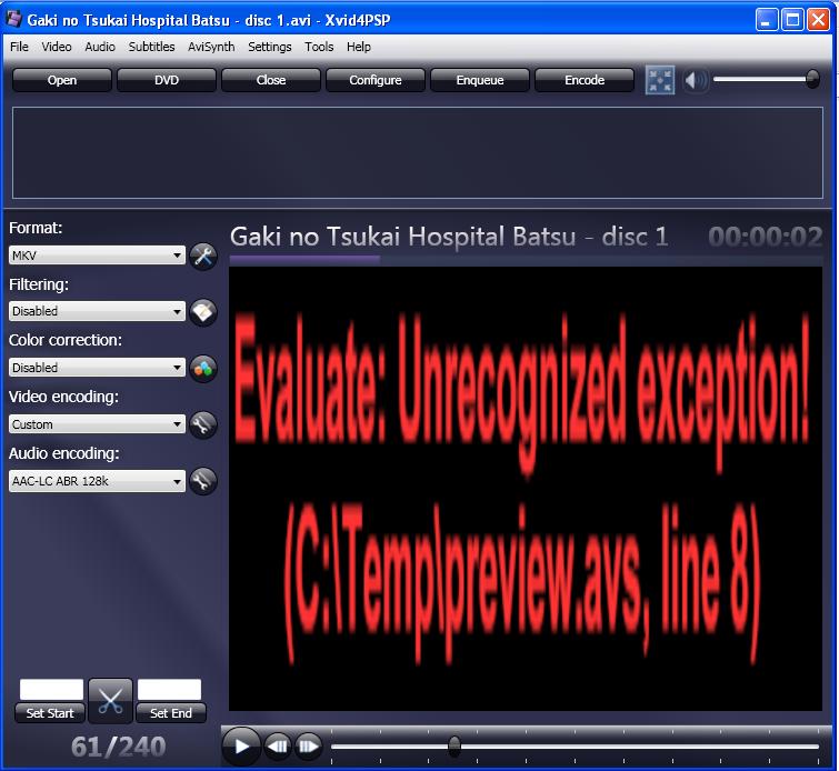

    That's not what I'm saying about the subs getting big. When I load the .ass file to the .avi file in XivD4PSP, it shut the video off and replaces it with these just large words that have nothing to do with the subs.
    The .ass file plays very nicely with the .avi video file. Not off sync, no issues at all except that when I open the video with the sub file before it plays it says "Red is replaced with Default, Blue is replaced with Default, Mustard is replaced with Default," just in three error windows. I'll definitely post this when I get home as I'm not right now but hopefully this can be figured out.

  13. Oh, it's not the sub dialog you see in big letters? Then guns1inger's probably right - an error message of some sort. Is it in red letters on a black background? If so, and if you can make out the writing, post the error message. If you can't read the message, then post the script XviD4PSP is using.
    May 2008
    You know what? Everytime I'd see that dialog, it'd be all squashed together but yes, now it is. Here's what it looks like:

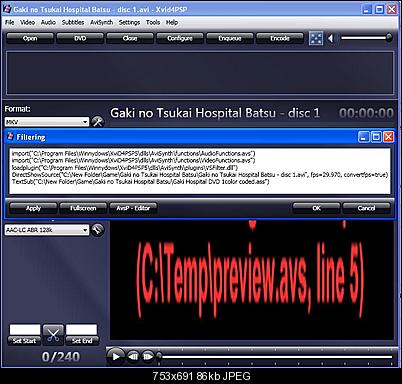

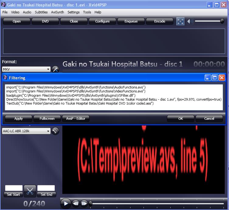

    I looked at the file and it shows this:
    import("C:\Program Files\Winnydows\XviD4PSP5\dlls\AviSynth\functions\AudioFunctions.avs")
    import("C:\Program Files\Winnydows\XviD4PSP5\dlls\AviSynth\functions\ VideoFunctions.avs")
    loadplugin("C:\Program Files\Winnydows\XviD4PSP5\dlls\AviSynth\plugins\VSFilter.dll")
    DirectShowSource("C:\New Folder\Game\Gaki no Tsukai Hospital Batsu\Gaki no Tsukai Hospital Batsu - disc 1.avi", fps=29.970, convertfps=true)
    AutoYV12()
    TextSub("C:\New Folder\Game\Gaki no Tsukai Hospital Batsu\Gaki Hospital DVD 1color coded.ass")
    ConvertToYUY2()
    I don't know what's wrong with it.

  19. Yes in xvid4psp (file, video, audio, subtitles,...the 5th heading says "avisynth")
    Copy & paste the script from avisynth=>edit filtering script , post it back here
    Won't let me copy the text for some reason.
  21. left click and drag a box around it (or ctrl+a to select all) , then right click "copy"
    What does the avisynth error message say? The red one? I can't read it. The dialog box is obscuring it

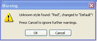

    I went through the frames and everything's there all in the right colors and placements though. These pop up as well:
    Three of these pop up with different colors like I've stated before.

  30. I'm not a subs expert, but I think you're missing a style sheet. Fancy subs can have attachments for exotic fonts, styles etc...
    So if you're missing the attachement, it will revert to a default style
    The script will work fine, however, if you just ignore the errors. You can save that script and feed it into vdub, for example, but you will only get what you see in the preview (if the .ssa file calls for those colors and fonts that you are missing, you won't get them)
